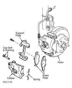

1999 Kia Sportage Two Wheel Drive Automatic
having trouble replacing brake pads on front.
Tried to put old ones back on and had trouble turning wheel. Need diagram to see if forgot something.
Jan 15, 2009 at 11:04 AM
DAVE H
  • 13,384 POSTS
Removal & Installation (Sportage) Raise and support vehicle. Remove 2 caliper assembly bolts, and pull caliper from disc. Remove flexible hose mounting bolt, and disconnect flexible hose from caliper. Remove brake pads from adapter. Remove 2 adapter mounting bolts, and then remove adapter. Remove 2 screws. Remove caliper. To install, reverse removal procedure. Tighten bolts and nuts to specification. See TORQUE SPECIFICATIONS . Bleed brake system. See BLEEDING BRAKE SYSTEM . Inspect brake system for leaks.
https://images.2carpros.com/forum/automotive_pictures/266999_brakes_4.jpg
hope this helps
