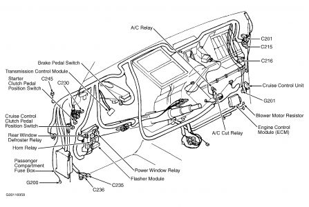

heater blower work only on high
Feb 22, 2009 at 2:24 AM
OBXAUTOMEDIC
  • 3,711 POSTS
Hello, It is most likely your Blower Motor Resistor. It is located under passenger dash on Blower Motor Housing. Check out the diagrams (Below). Let us know what happens and please upload pictures or videos of the problem......................
