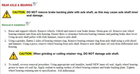

how to replace bearings in differential
Sep 30, 2010 at 5:01 AM
BLUELIGHTNIN6
  • 16,542 POSTS
https://images.2carpros.com/forum/automotive_pictures/261618_Noname_2796.jpg
