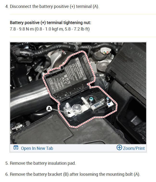

I’ve been having trouble starting the car, especially during cold winter temperatures. A week ago, I started the car in the evening, and while it started fine, it struggled a bit, taking a few extra seconds to turn over. The next morning, it had trouble starting again, and it took about an hour and a half before it started normally.
Last night, I started the car again because of the cold temperatures (around -18°C), but this morning it wouldn’t start at all. The fuel level is above half, and I’ve ruled out leaving lights or other accessories on for long periods.
The car makes a clicking sound when I try to start it, as if it’s struggling to turn over, but it doesn’t fully start. Could this be related to a weak or failing battery? I would appreciate your help in diagnosing and advising on the best next steps.

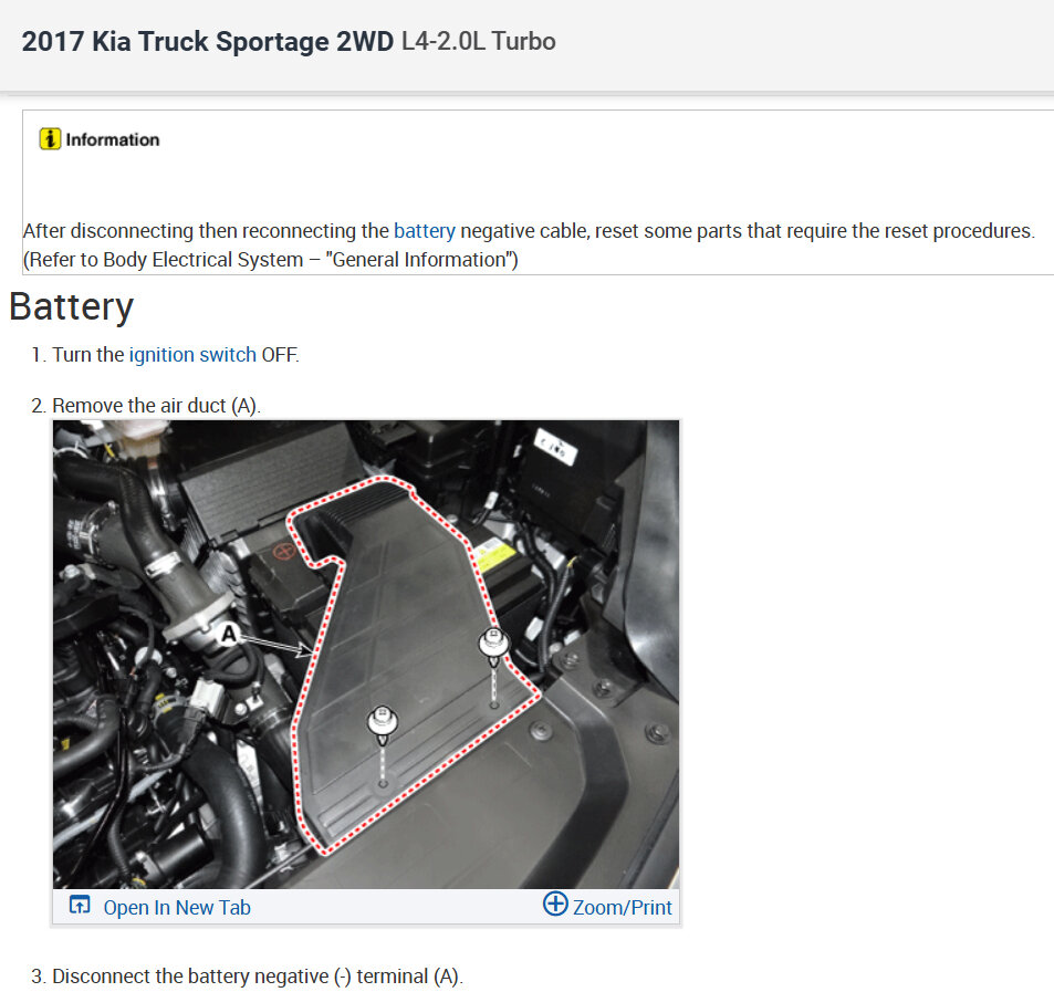

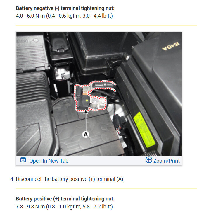

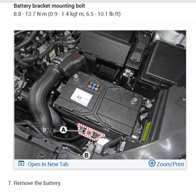

Yes, you have the right idea, in the wintertime car batteries go bad, tizz the season as my dad would say. Here is a way to load test the battery or you can remove it and have the auto parts store test it for you:
Check out the images (below). Please upload videos in your response of any problems so we can see what to help you with.
