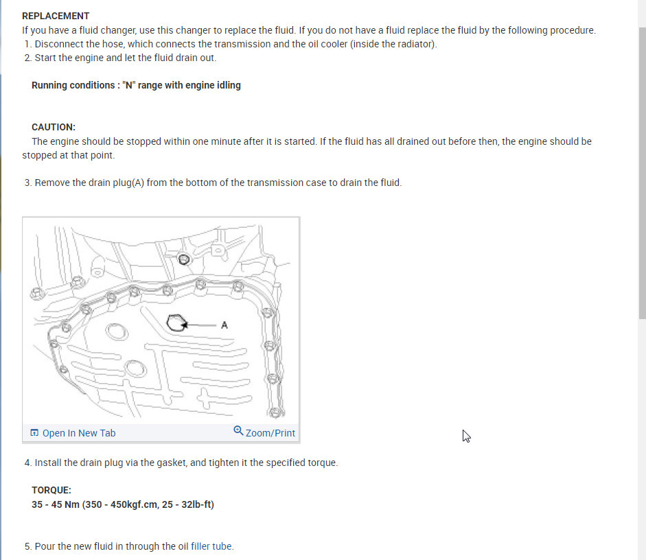

i drove my car yesterday and it ran great today i noticed an oil only leak and i fixed the pan and changed the oil, and i started the car and it wouldn't move i checked the transmission fluid and it was gone. so i want to change the fluid and filter please help.
Oct 21, 2010 at 12:34 AM
  • CAR REPAIR CONTRIBUTOR

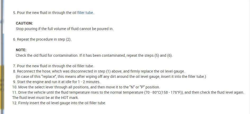

Here is a guide that will help with step by step instructions on how to do this service:
Below is the process from the manual that will help with this as well.
Please run through this info and let us know if you have other questions. Thanks
