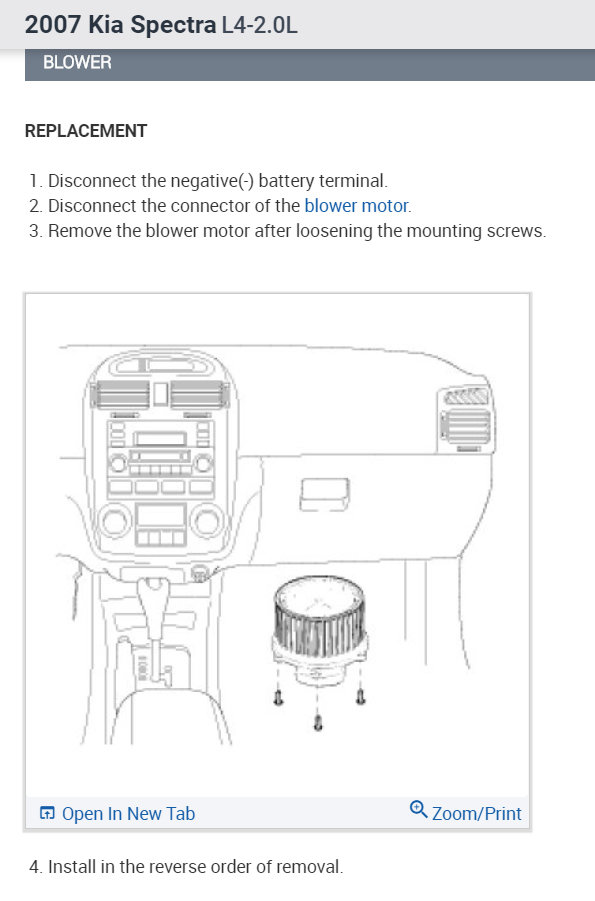

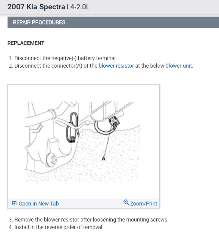

Air conditioning fan not working. The air condition comes on but no fan
Jun 25, 2010 at 10:58 AM
  • 75,992 POSTS
Probable causes here could be the blower motor, resistor, blower relay or the fuse. This guide will help you see whats going on with diagrams below to show you the blower and resistor locations.
