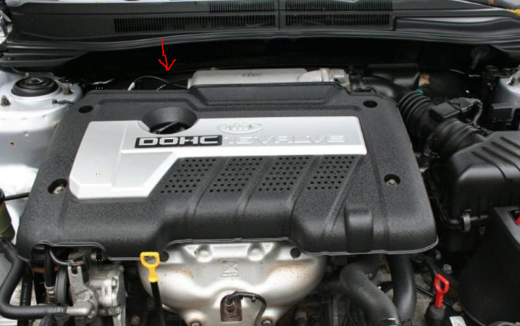

My 2006 kia spectra leaks alot of water on passenger side floor when either the a/c or defrost is running unable to find repair manual how do i fix this?

There is a drain hose that is located on the fire wall on the passenger side (look at the picture below), closer to the bottom of the fire wall.
That hose drains the evaporator.
That drain can be blocked by dirt of debris.
When that happens the condensation from the evaporator will get backed up and drain to the inside of the vehicle.
Simply locate the drain and clean it out to fix the issue.
