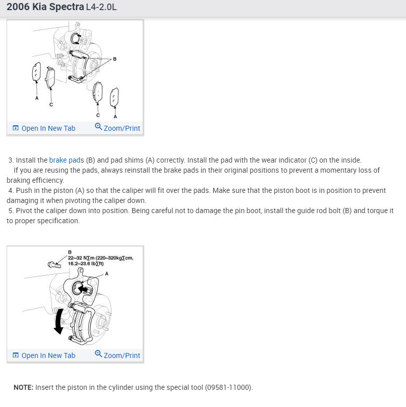

The piston in the caliper can be retract using a caliper tool that presses the piston or a large C-clamp.
Before trying to retract the piston, be sure to remove the brake fluid reservoir cap.
Here is a helpful guide:
If you are still unable to push the piston back in that it is probably seized and the caliper needs to be replaced.
https://www.2carpros.com/articles/brake-caliper-replacement
