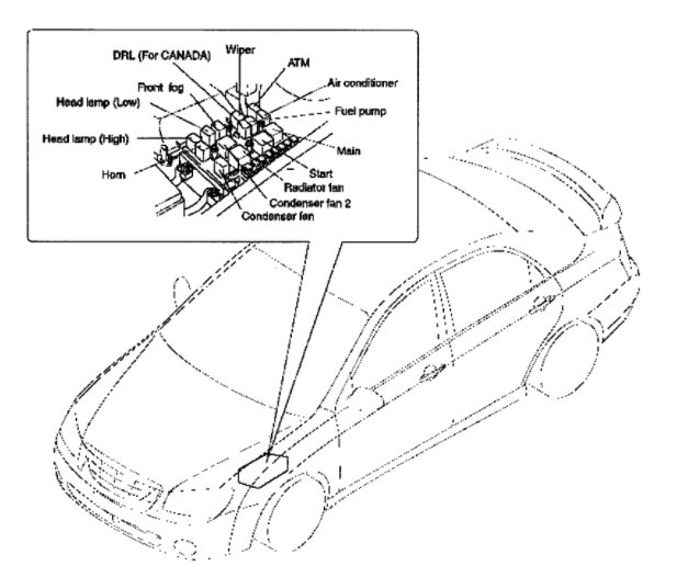

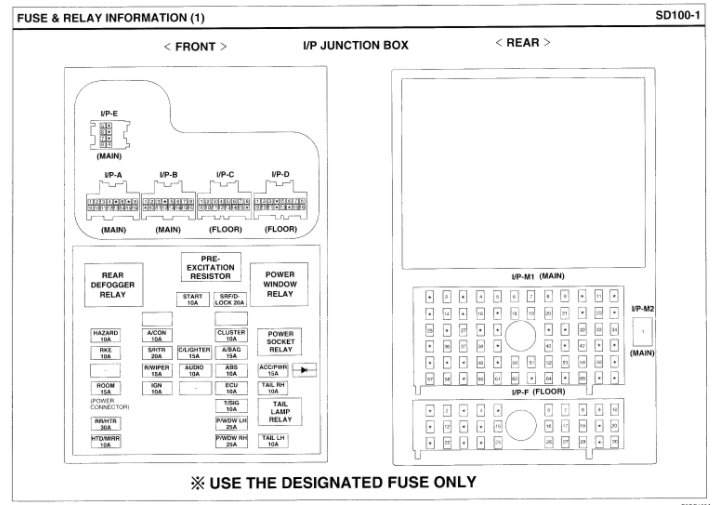

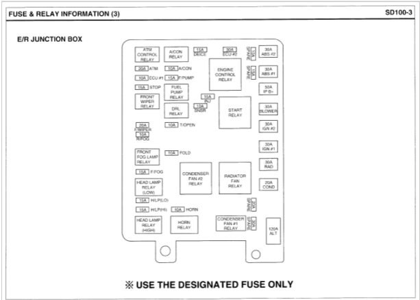

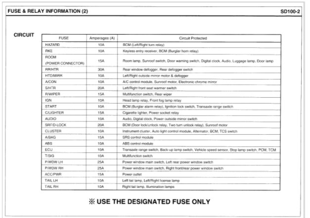

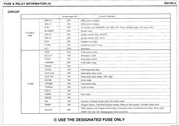

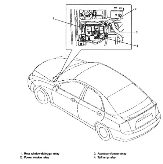

How do I change the fuses in my car I need to test them because my lights are not working?
Saturday, November 8th, 2008 AT 4:59 PM
DANNY L
MECHANIC
5,648 POSTS
Hello, I'm Danny.
Here is the information you requested. Here are a few tutorials for you to view on how to check and replace fuses:
I've attached pictures below showing the fuse and relay locations on your car. Hope this helps and thanks for using 2CarPros.
