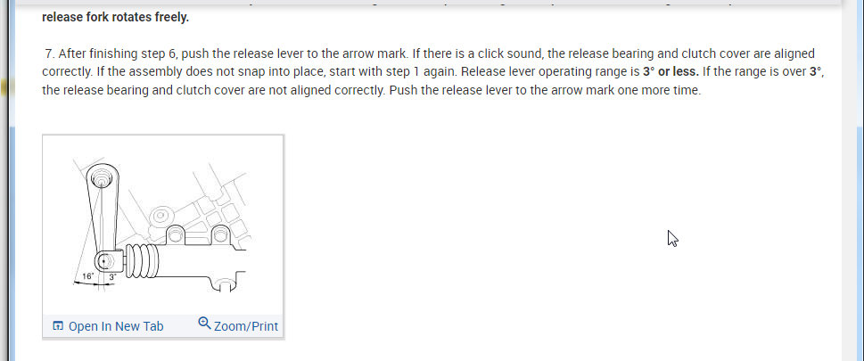

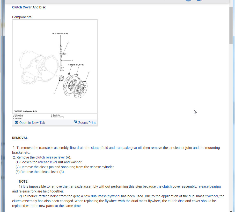

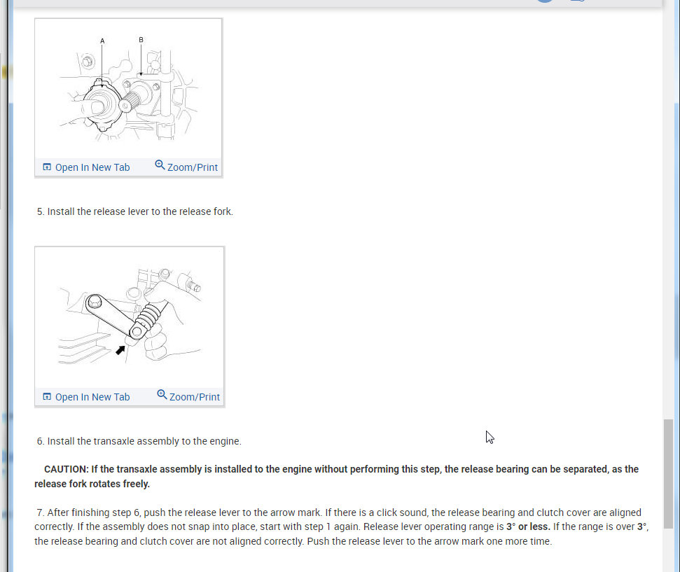

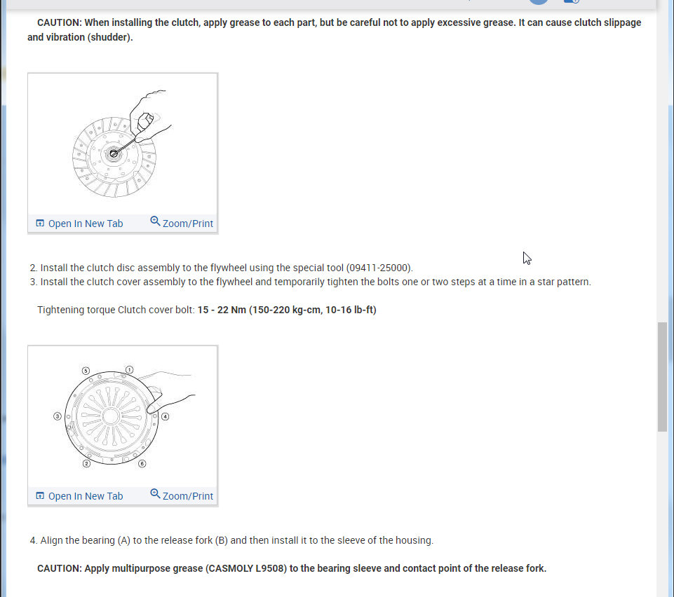

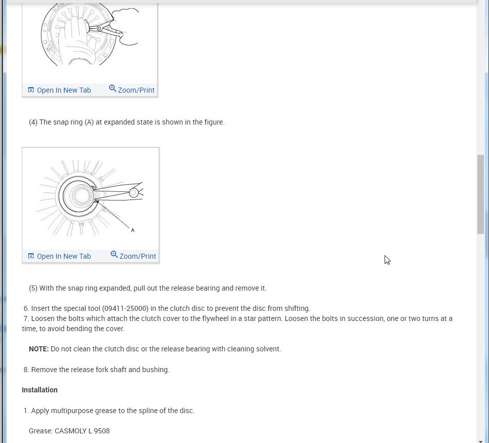

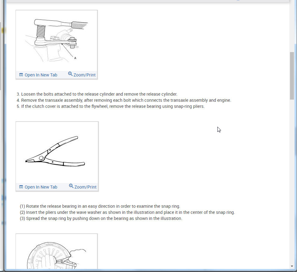

More than likely I suspect there is either still something connected or the input shaft or bearing is seized that is not releasing.
I also attached the process from the manual just to make sure something is still not connected.
Please run through all this material and let us know if you have other questions. Thanks
