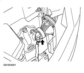

How do you change the bulbs on my 2005 Kia Spectra 5? I need to know the steps in order to replace the bulbs.

FRONT FOG LAMPS REPLACEMENT Disconnect the negative (-) battery terminal. Remove the front fog lamp after loosening the screws and disconnecting the fog lamp connector. Fig. 4: Removing The Front Fog Lamp Courtesy of KIA MOTORS AMERICA, INC. Installation is the reverse of removal.
