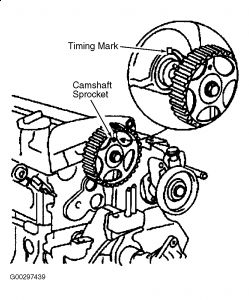

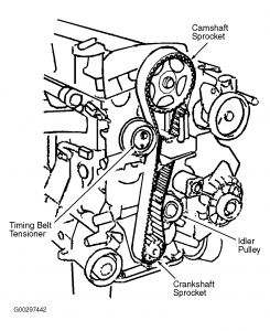

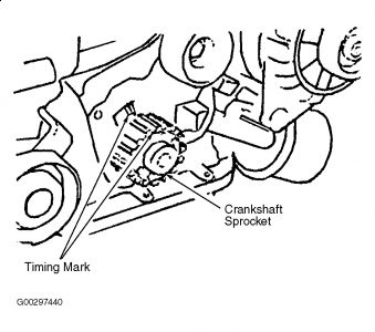

I need a diagram for the timing chain and timing belt. thanks

Your car shows a timing belt, not a chain this
https://images.2carpros.com/forum/automotive_pictures/198357_Graphic_384.jpg
https://images.2carpros.com/forum/automotive_pictures/198357_Grafic_3_100.jpg
https://images.2carpros.com/forum/automotive_pictures/198357_Grafic_4_22.jpg
Check out this link for larger image's https://www.2carpros.com/diagrams/kia/spectra/2005 Please let us know if you need anything else to get the problem fixed.

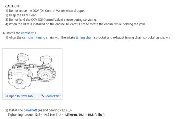

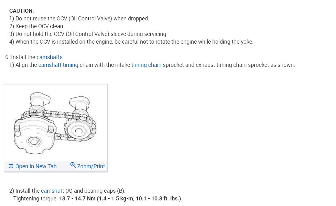

it does have a timing chain in back of head connecting the 2 cams

Here are the marks for the rear of the camshaft chain. Not the cam lobes.
