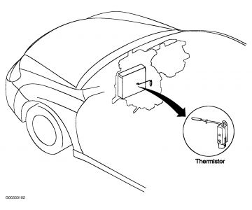

I'm a certified ASE tech, and need help. Head pressure's are fine, temp switch bypassed, but the system is still short cycling. The EVAP thermistor is all thats left besides the a/c computer. How do I know if the problem is the thermistor, or the computer?
Jan 20, 2009 at 7:42 AM
DAVE H
  • 13,384 POSTS
https://images.2carpros.com/forum/automotive_pictures/266999_therm_2.jpg

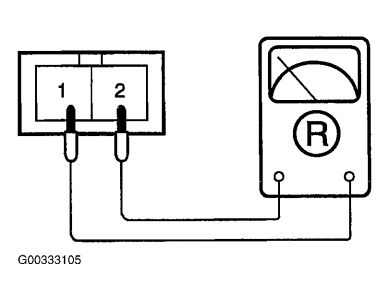

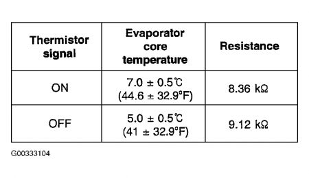

INSPECTION Start the engine. Turn on the air conditioner. Using the multi-tester, check the resistance between terminals 1 and 2 in the thermistor. Fig. 56: Testing Thermostatic Switch Resistance
https://images.2carpros.com/forum/automotive_pictures/266999_therm1_1.jpg
https://images.2carpros.com/forum/automotive_pictures/266999_therm2_2.jpg
