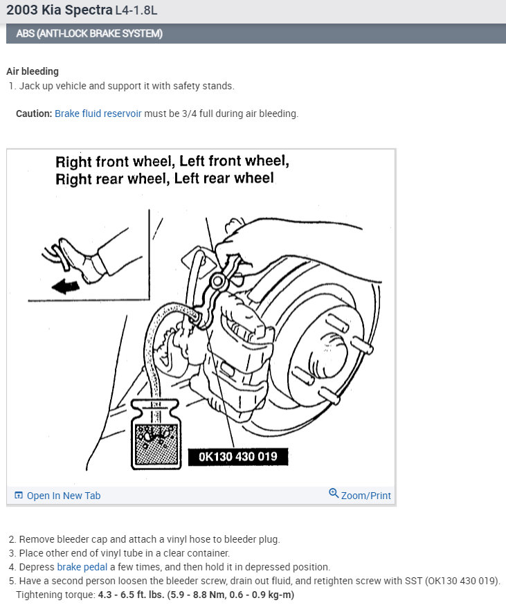

I drove my girlfriends car last week for the 1st time in about 4 months. Her brake pedal goes basically to the floor when you press it. I have checked the pads in the front and shoes in the rear. They were all in good shape along with the calipers and wheel cylinders. I have bleed the system twice times. When that did nothing i changed the master cylinder. Bleed the system twice again and still nothing. i have run out of ideas. please help.

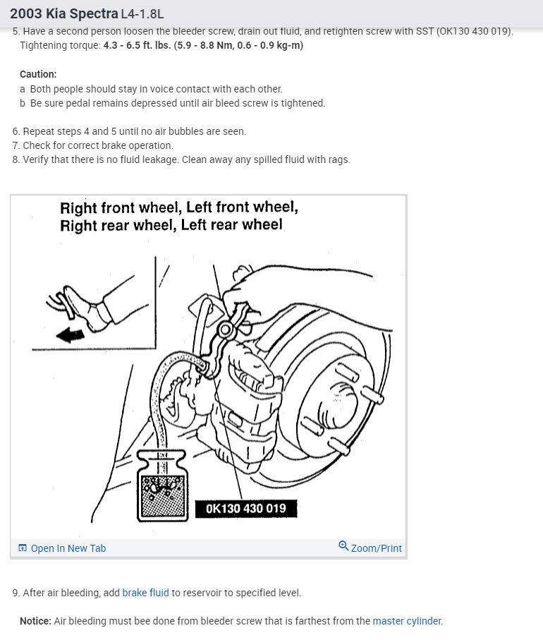

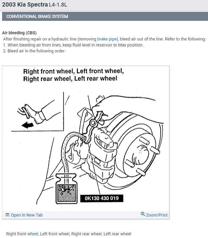

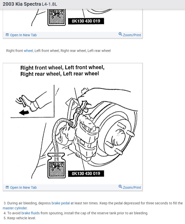

Keep in mind that if the brake bleeding not done as per the recommended process, you might not be able to get all the air out.
Also, if this vehicle is equipped with ABS the bleed procedure is little different.
https://www.2carpros.com/articles/how-to-bleed-or-flush-a-car-brake-system
I have attached diagrams for both ABS and non-ABS brake system.
