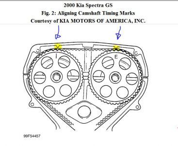

mark thanks for that tip. One last thing if both my cams have dots which i can line up with engine at 12:00 and Lt cam has another mark at 3 and rt at 9 then if i line these up this will be TDC on cylinder one or could it be 180 degrees off?

Align cam timing marks as per pic, tooth adjacent to cam indicator is the alignment point.
