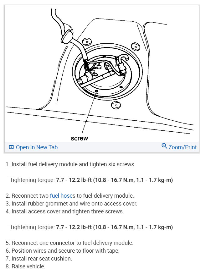

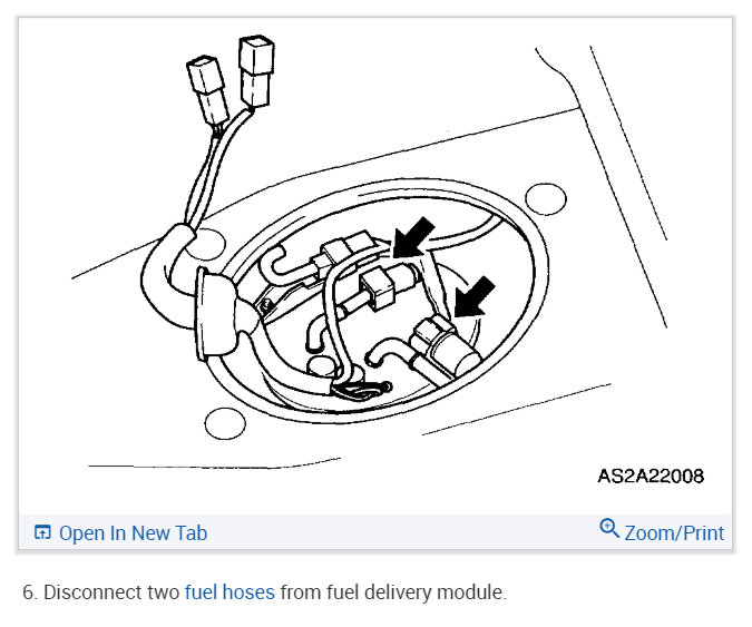

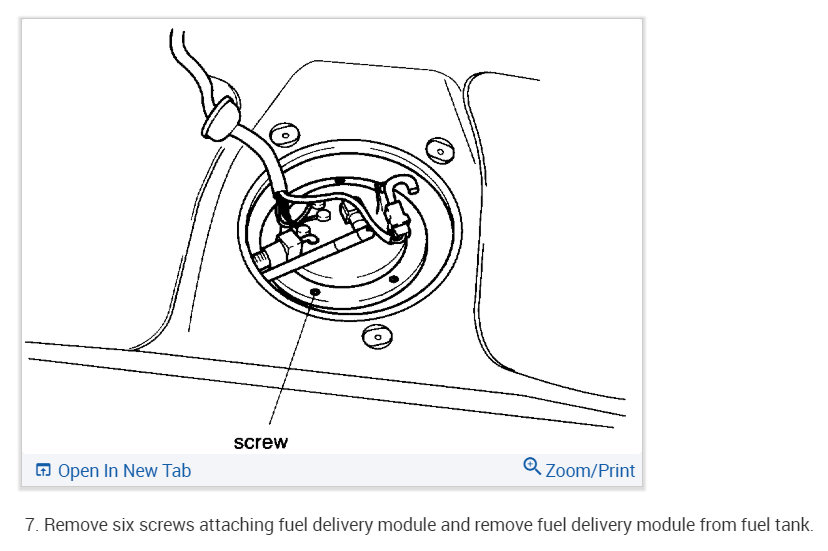

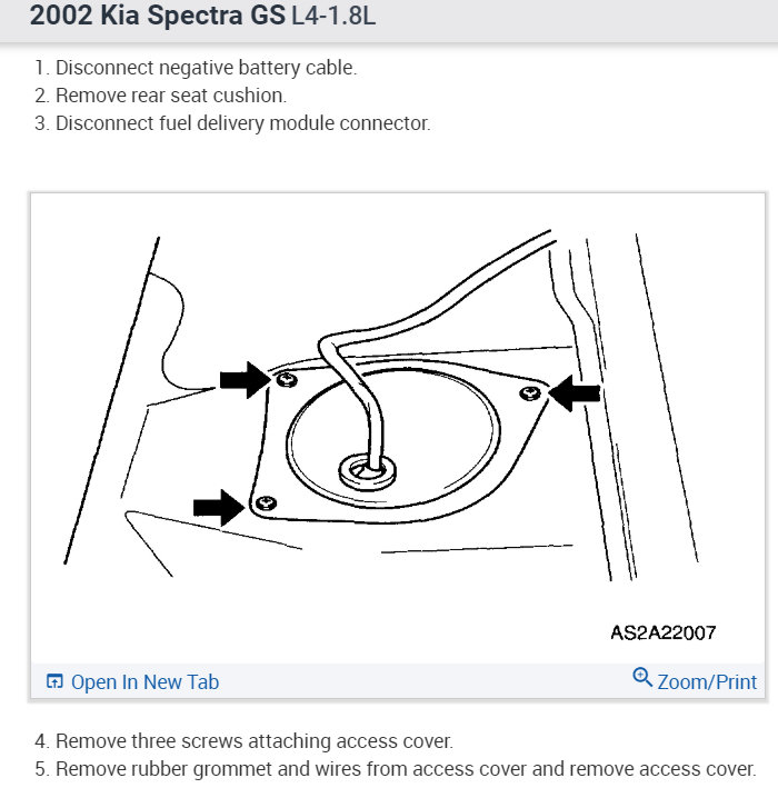

How do I check and replace the fuel pump in my 02 Kia Spectra LS. I also need to check and replace the fuel filter. Where are these located and what is the best way to do it?
Sep 28, 2010 at 9:07 AM
WRENCHTECH
  • 20,760 POSTS
Here is a guide to help you check the fuel pressure and to remove the fuel pump with diagrams below to help you see how to do the job on your car.
and
https://www.2carpros.com/articles/how-to-replace-an-electric-fuel-pump
You are lucky this car has a trap door for the fuel pump in the tank. Check out the diagrams (Below). Please let us know if you need anything else to get the problem fixed. Cheers
