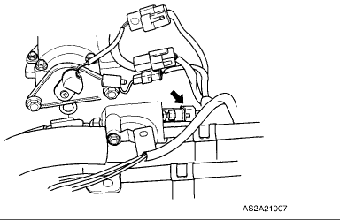

My check engine light came on. I took it to auto zone for diagnosis. They said I needed an engine coolant replacement sensor. How difficult is this to do and how expensive? Is this something I could possibly do on my own?

Service and Repair Engine coolant temperature sensor Removal NOTE: Engine coolant temperature sensor is located near thermostat. 1.Disconnect engine coolant temperature sensor connector.
https://images.2carpros.com/forum/automotive_pictures/12900_ec_1.gif
2.Remove engine coolant temperature sensor. Installation 1.Install a new washer and engine coolant temperature sensor onto engine. Tightening Torque: 18 - 22 lb-ft (25 - 29 N.m, 2.5 - 2.9 kg-m) 2.Connect engine coolant temperature sensor connector.
https://images.2carpros.com/forum/automotive_pictures/12900_ec2_2.gif
3.Start engine and check for coolant leakage. https://www.2carpros.com/kpages/auto_repair_manuals_alldata.htm
