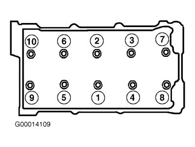

2001 Kia Spectra Head Bolt Torque Spec
2001 KIA SPECTRA
177,121 MILES • 4 CYL • FWD • AUTOMATIC
KHRISW
Looking for the torque specs for a 1.8 dohc head bolts.
Sep 27, 2010 at 3:23 PM
BLUELIGHTNIN6
  • 16,542 POSTS

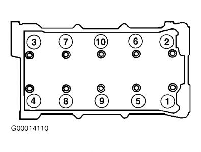

use 6 steps to tighten head bolts, follow sequence below (diagram 1). step 1 36 Ft. Lbs step 2 loosen all bolts (in sequence, diagram 2) step 3 29 Ft. Lbs. step 4 Mark bolts for rotational reference step 5 turn additional 90 degrees step 6 turn additional 90 degrees Fig. 1
