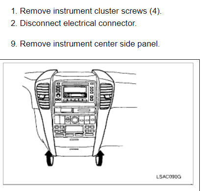

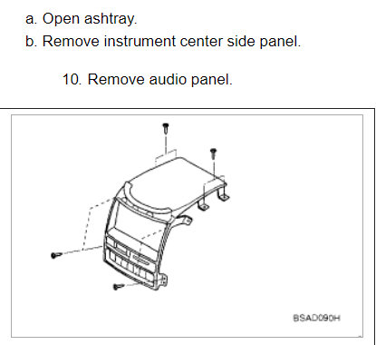

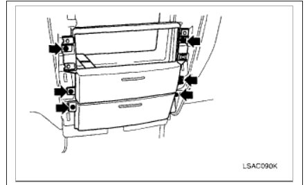

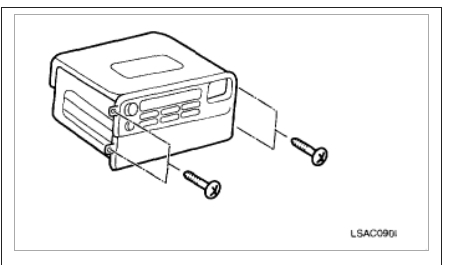

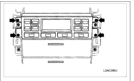

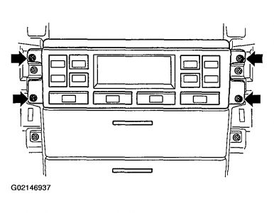

The lights for the heater controls is in need of replacement. how can i remove the panel to replace the lamps?
Nov 29, 2008 at 1:55 AM
  • 55,381 POSTS
Hello, Here are diagrams to help you remove the heater controller (below)
https://images.2carpros.com/forum/automotive_pictures/266999_kia_1.jpg
Check out the diagrams (Below) Please let us know if you need anything else to get the problem fixed. Cheers, Ken
