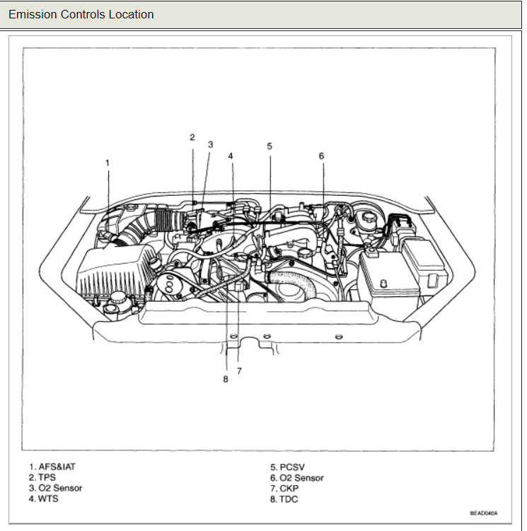

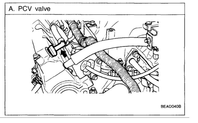

Where is my pcv valve located on my 2006 kia sorento i looked and could not see it. Im looking for a diagram and could not find one. Please tell me a specific location

The PCV valve is located on the valve cover on the right side of the engine toward the front here is a diagram to help you see better. Check out the diagrams (Below) Please let us know if you need anything else to get the problem fixed.
