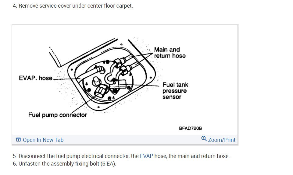

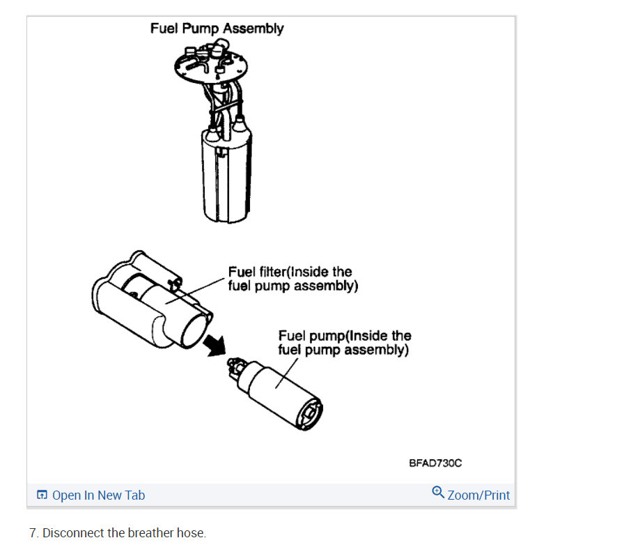

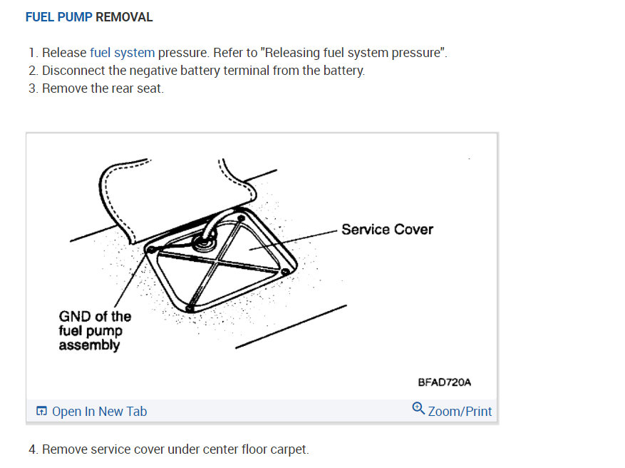

Wife was driving car and just died and would not start. She was headed to work Monday morning and car just died while driving.Loaded car onto trailer to bring home.Disconnected battery while trailering home (appx 1 hour) get car home and off trailer reconnect battery and it starts fine.I have to replace the fuel pump.
Aug 4, 2010 at 10:41 AM
Good evening,
I attached the procedure below for you for the fuel pump.
https://www.2carpros.com/articles/how-to-replace-an-electric-fuel-pump
