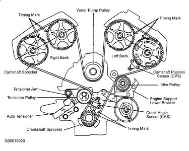

Ok so I replaced the driver side cylinder head on my Sorento. Everything is still disassembled but the head is mounted. I am at the point where I will need to time the engine. Is there an easy way to go about doing the timing or do I have to take off all of the pulley assemblies to do the timing?
Thursday, February 4th, 2010 AT 8:53 AM
2CARPRO JACK
  • 11,533 POSTS

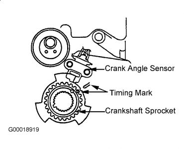

You will need to time the entire engine. These timing marks should have been lined up before disassembly. I can post apic of the marks aligned, what size engine is it? Is it a DOHC or SOHC engine?
Thursday, February 4th, 2010 AT 11:50 AM
JEOSH16
It is a DOHC.
I didn't align all of the marks before disassembly. Does that mean it can't be timed?
Thursday, February 4th, 2010 AT 6:52 PM
2CARPRO JACK
  • 11,533 POSTS
It can still be timed, but it will be difficult to get all of it lined up.When you move the crank, it can hit the valves, when you move just one cam in a head (say intake) they can make contact with the other valves (exhaust) this is why you should time the engine before disassembly.Here are the pics of how the marks should align. When the crank mark is aligned it is on TDC, you may want to back it off about 1/8 off mark, this should put the majority of the pistons down in the cylinders a little so as to HOPEFULLY not contact the valves when trying to align the marks. I would remove the cams from the head you did the gasket on as well, after the other side is tmed, you can always install the cams where they should be or at least very close.That way you dont have to worry about damaging anything on that head.If at any time you are rotating a cam and it stops, DO NOT force it, it may be making contact with something
