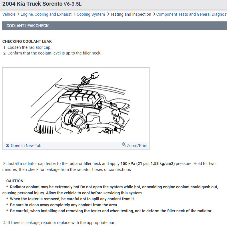

I have a leak in the car by the antifreeze holder. The radiator is not leaking. I go through a gallon of antifreeze in 3 days? What could this be?

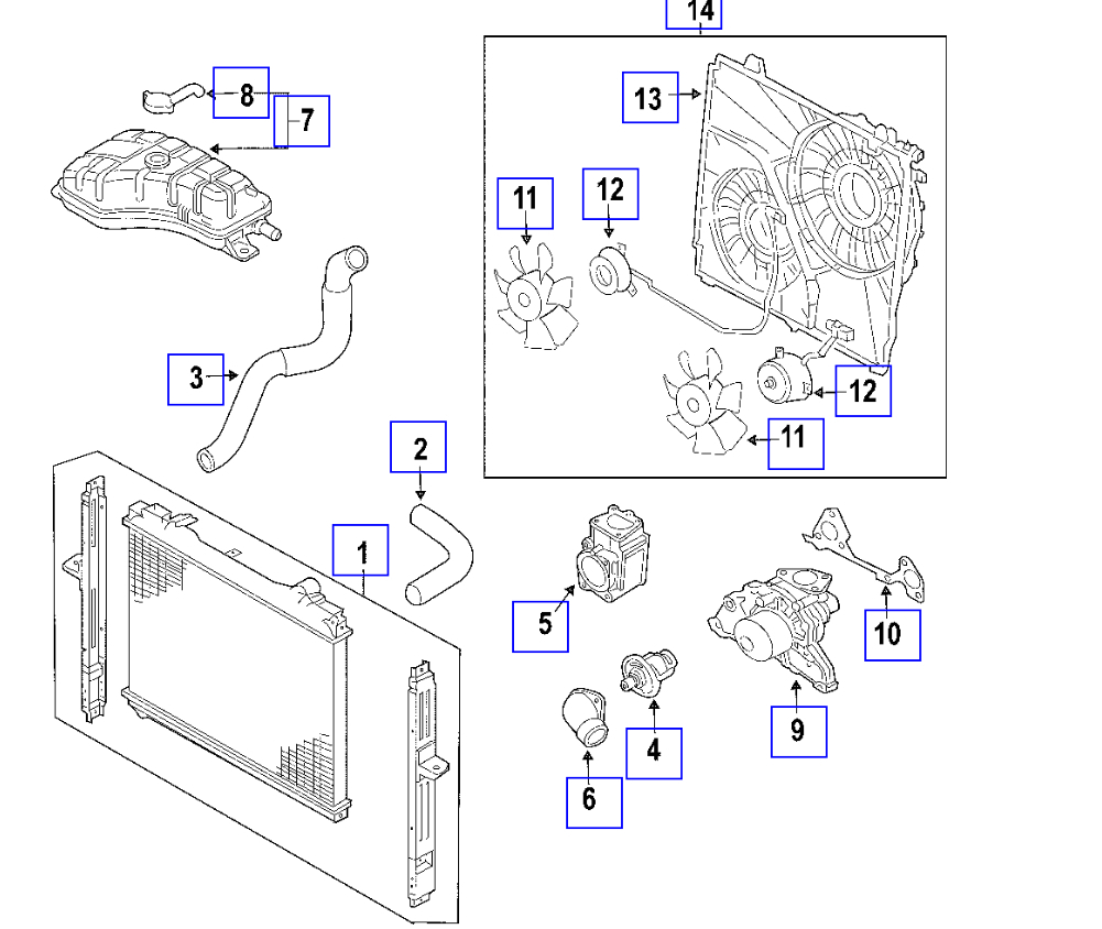

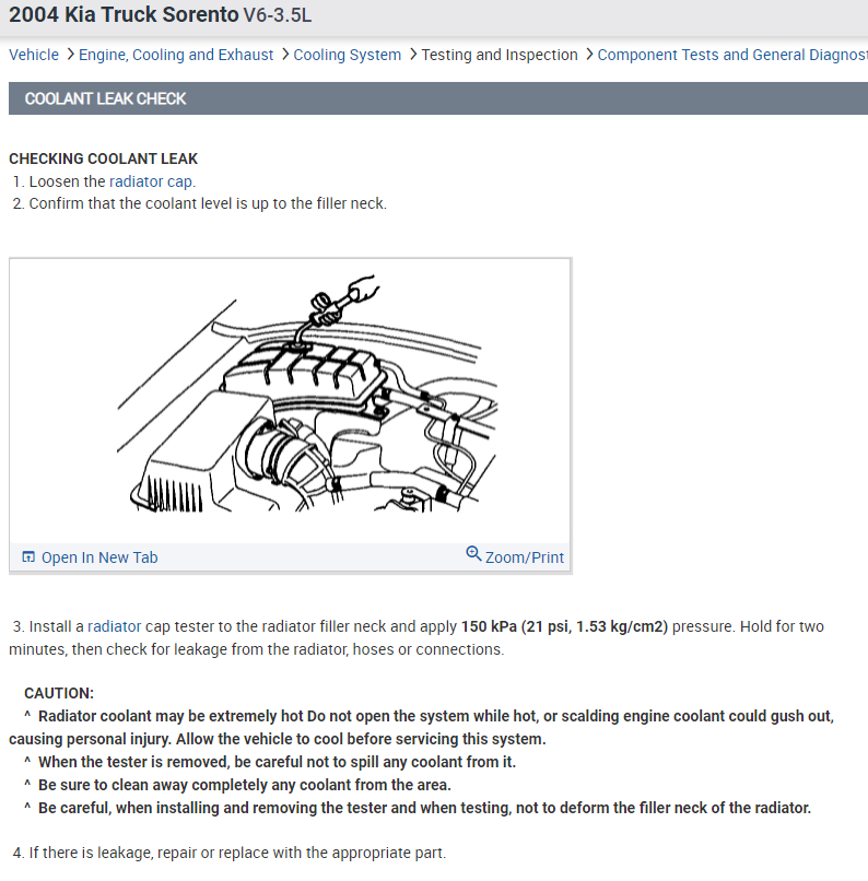

Can you tell if it is leaking from the reservoir of the hose that is connected to it?
If it is the house you will just have to replace the house. If it is the reservoir then you will have to replace that part.
Here is a helpful article of how to replace the reservoir:
