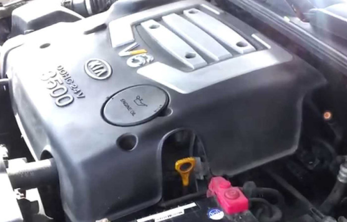

A strong odour of fuel inside and outside would usually indicate a fuel leak from the fuel supply system, from the fuel tank to the engine. With the engine idling have a look underneath your vehicle and see if there is any obvious fuel leaking/dripping on the ground.
Also open the hood and inspect the area around the fuel lines and injectors for dampness.
This is easier done if you first remove the engine cover to gain access. See picture below
A leaking or faulty injector would usually cause rough running or misfire issues.

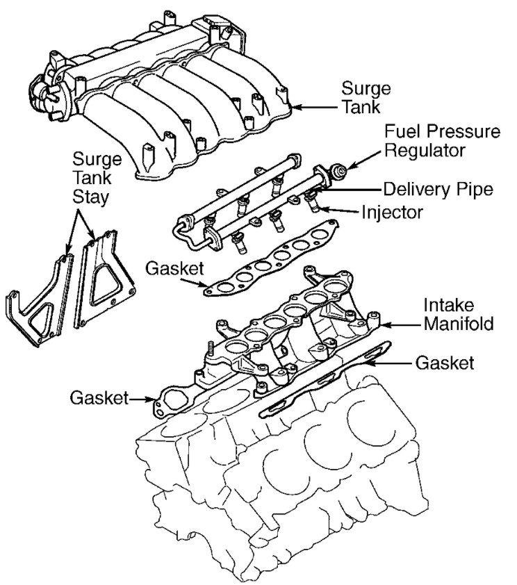

To access the fuel injectors the intake plenum will have to be removed, see picture attached
To remove the intake plenum please see links below
https://youtu.be/G8AMdPFxUns
and
https://youtu.be/8-h4ai3D1qc
