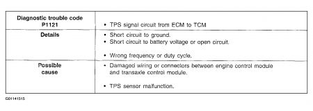

i get this high vibration at 30 miles the mil came on and the OBD-CODE read p1121 and p0700
is there any thing else i must do or just go ahead and perchase the parts that are not funtioning

Replace the TPS with a new one from KIA 35107-39000FFF ( I believe), Make sure you adjust it correctly, as well as idle speed. There was a tsb on this I believe, but make sure you get the updated one.
