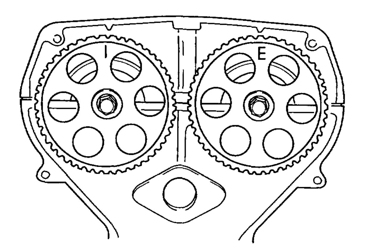

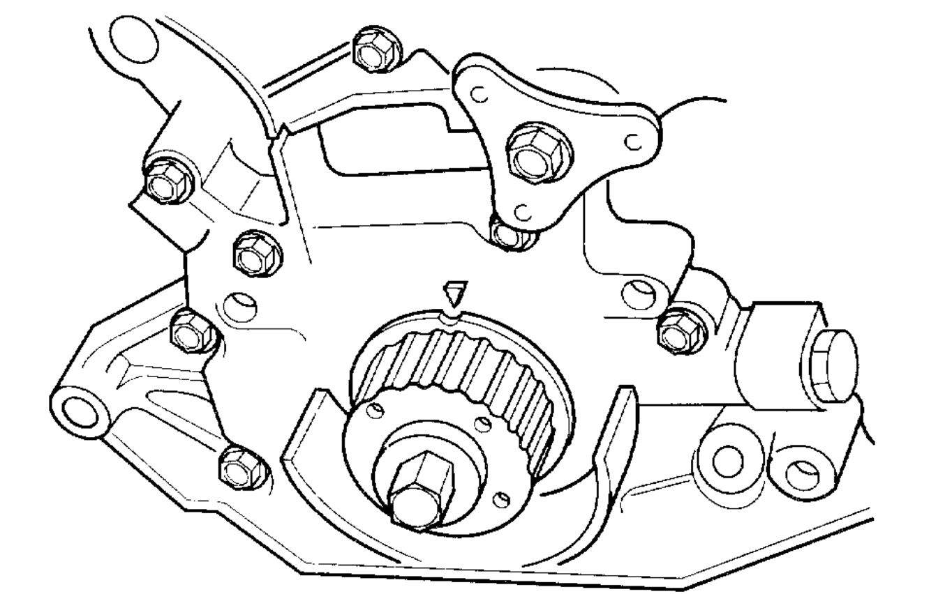

There are three timing marks, which do I use to align when replacing the timing belt?

Check out the attached diagrams of the timing marks. Be careful ,this is an interference engine so you want to pay close attention to the marks
See timing mark diagrams below
