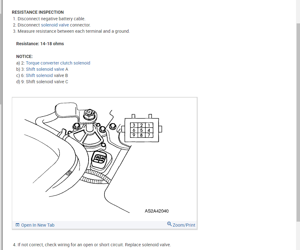

the car slips in drive till about 40mph. but if i put it in 1st or 2nd gear manually the gears don't slip at all what could be causing that? i have been told it is the shifting control module but i would hate to change something that isn't needed.
May 28, 2009 at 6:20 AM
More than likely this is a torque converter issue or simply a fluid issue.
I would suggest starting with checking the fluid level and condition and then change it if it is at all dirty or low.
Here is a guide that will help with this:
Also, here is a guide that will help with transmission issues in general as this may shed some light on what we are seeing with this:

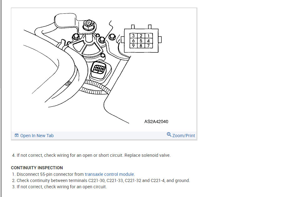

However, below is a test that we can run through for the torque converter solenoid just to find out if it is functioning. If it is then the clutch itself is slipping and will require replacement.
Please run through all this testing and let us know what you find. Thanks
