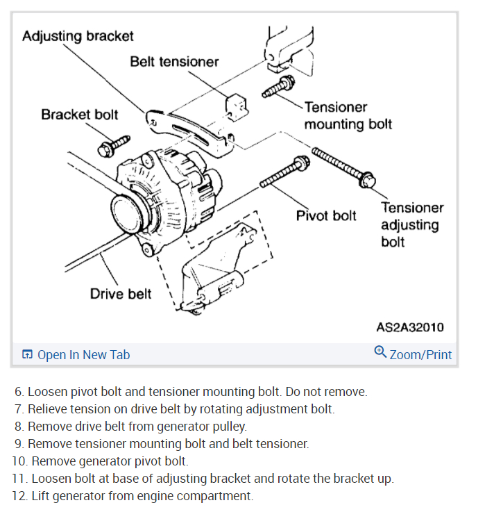

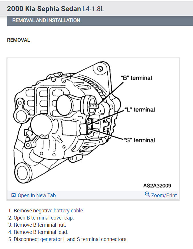

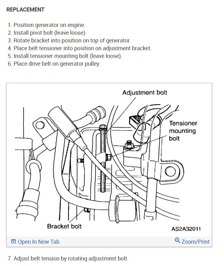

took alt off motor how to get it out area its in
Feb 26, 2010 at 12:04 PM
BLUELIGHTNIN6
  • 16,542 POSTS
This guide will help walk you through the alternator replacement with instruction for your car in the diagrams below.
https://www.2carpros.com/articles/how-to-replace-an-alternator
