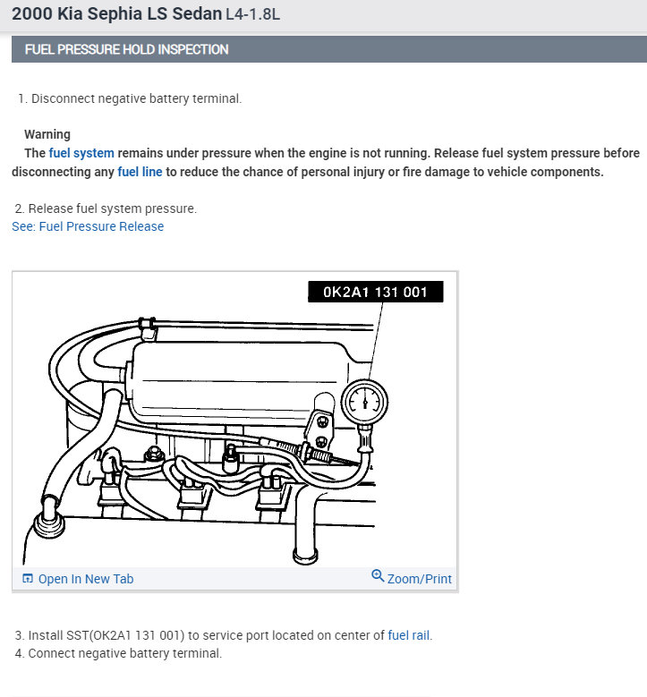

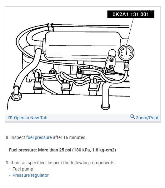

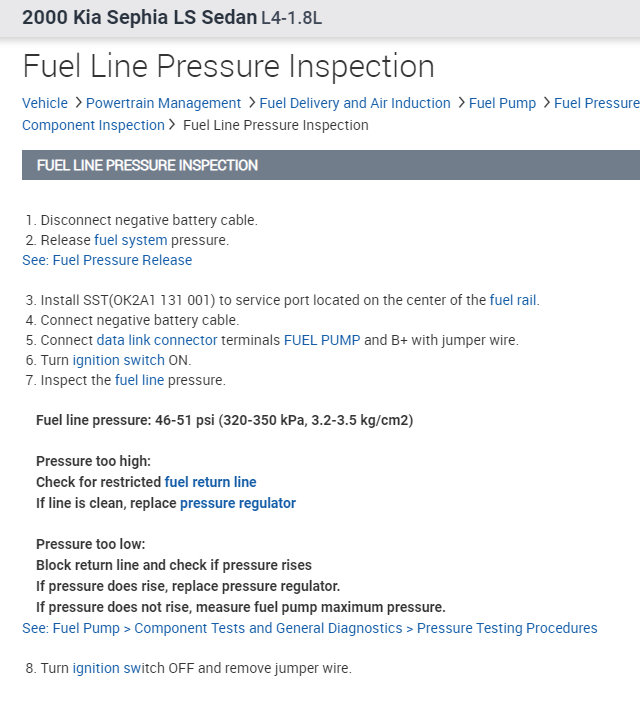

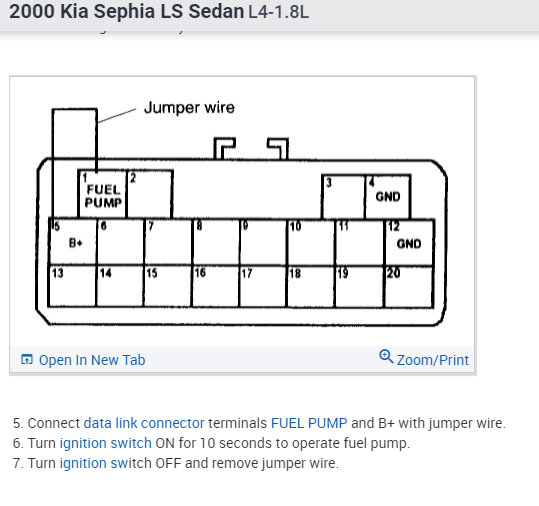

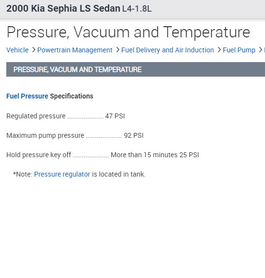

What should the fuel pressure be from the fuel pump? Plus how do I test it?
May 28, 2009 at 8:39 PM
SQM
  • 6,383 POSTS
On this the fuel pressure should be 47 PSI at the fuel rail and maximum pump output should be 92 PSI.
There is a port on the fuel rail that you can attach a pressure gauge to check the fuel pressure.
