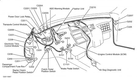

WOULD LIKE TO KNOW WHERE THE ECM COMPUTER IS LOCATED IN A 2000 KIA SEPHIA

Your vehicle's ECM is located below the right center of the dash.
https://images.2carpros.com/forum/automotive_pictures/261618_Graphic_178.jpg
