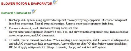

Where is the blower motor resistor and how do I get to it

The blower motor resistor is below right side of dash

The blower motor resistor should be attached to , or close to the blower motor itself, which is below the right side of the dash. Just follow these blower motor removal steps until you have gained access to the resistor, then simply replace the resistor and reverse the order.
https://www.2carpros.com/forum/automotive_pictures/261618_Noname_582.jpg
