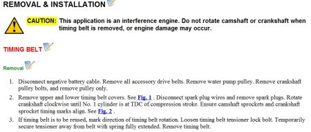

https://images.2carpros.com/forum/automotive_pictures/261618_Noname_2728.jpg

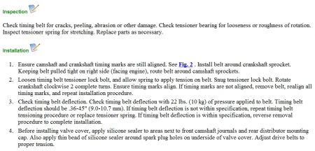

https://images.2carpros.com/forum/automotive_pictures/261618_Noname2_887.jpg

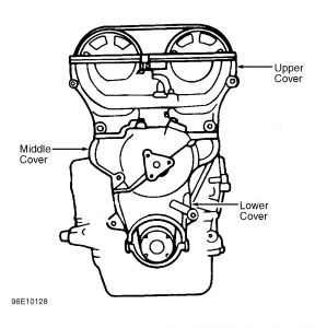

FIG. 1
https://images.2carpros.com/forum/automotive_pictures/261618_1_197.jpg

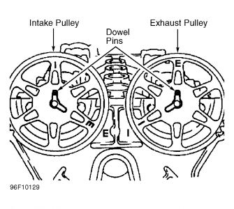

FIG. 2
https://images.2carpros.com/forum/automotive_pictures/261618_2_127.jpg
