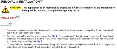

https://images.2carpros.com/forum/automotive_pictures/261618_Noname_2728.jpg

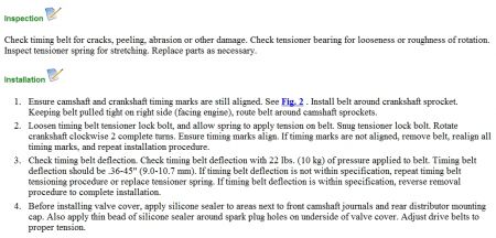

https://images.2carpros.com/forum/automotive_pictures/261618_Noname2_887.jpg

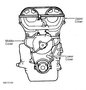

FIG. 1

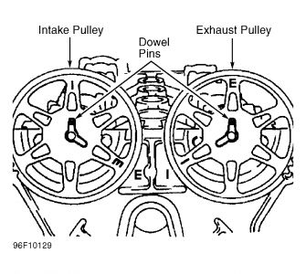

FIG. 2
