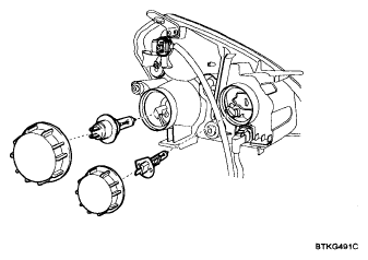

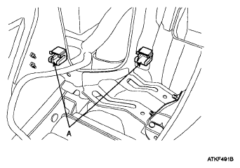

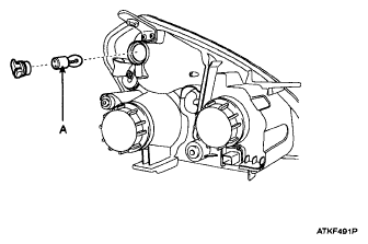

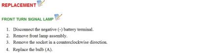

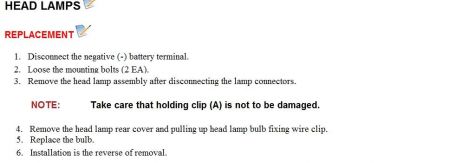

My right front turn signal is out. How do I get the headlight assembly out to replace it?
