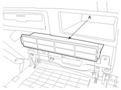

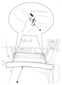

HOW DO YOU INSTALL A CABIN AIR FILTER.
I KNOW IT'S BEHIND THE GLOVE BOX. THE SUPPORT ROD COMES OFF EASY, BUT I'M
HAVING TROUBLE TRYING TO DISSCONECT THE
TWO STOPPERS, ONE ON EACH SIDE OF THE GLOVE BOX. THANKS FOR ANY HELP YOU CAN GIVE ME. TOM

REPLACEMENT Open the glove box (B). Lower the glove box down completely by removing the glove box stopper (A) to the glove box.

Remove the filter cover (A) with pushing the knob. Replace the air filter (B), install it after making sure of the direction of air filter.
