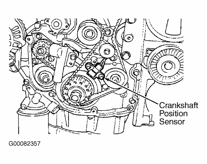

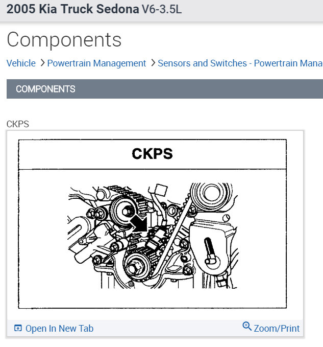

Crankshaft position sensor where is it located?
2005 KIA SEDONA
86,500 MILES • 6 CYL • 2WD • AUTOMATIC
KBROWNSR
crankshaft position sensor where is it. Is it easy to replace how much time to replace it?
Mar 19, 2009 at 8:24 PM
DAVE H
  • 13,384 POSTS
The Crankshaft Position Sensor is next to crankshaft sprocket. Here is a diagram below to show you the location and how to replace it. This guide will walk you through the steps with diagrams below for your car.

it pays 2.5 hours and is located under the timing cover down by the harmonic balancer. if you have never done this, i do not recommend trying it as you may get in over your head real quick. very labor intensive job. better left to an experienced shop.

It is located near the harmonic balancer on the front of the engine. It bolts in place. It should take aprox 30 minutes of labor to install.

with only 39k miles, i would venture to assume it may be covered under factory warranty. but if not, it's about a 3 hour job. remove the serpentine belt, balancer pulley, and necessary accesories, remove the timing cover, the crank sensor is just above the crank gear for the timing belt. always wise to replace the belt while you're in there if there's any signs of abnormal wear. if not, mark directional rotation & set timing marks & reinstall exactly as removed, if necessary to remove belt for sensor replacement. some vehicles, you can snake the sensor out without having to remove the timing belt. best of luck. :)

The crank shaft position sensor is located behind the front engine cover so there is a bit of work to get to it, Mitchell 1 data base allows 3 hrs, to do the job but I feel that around 2 may be closer to the mark, so to stay safe anywhere between 2-3 should be ample time.
