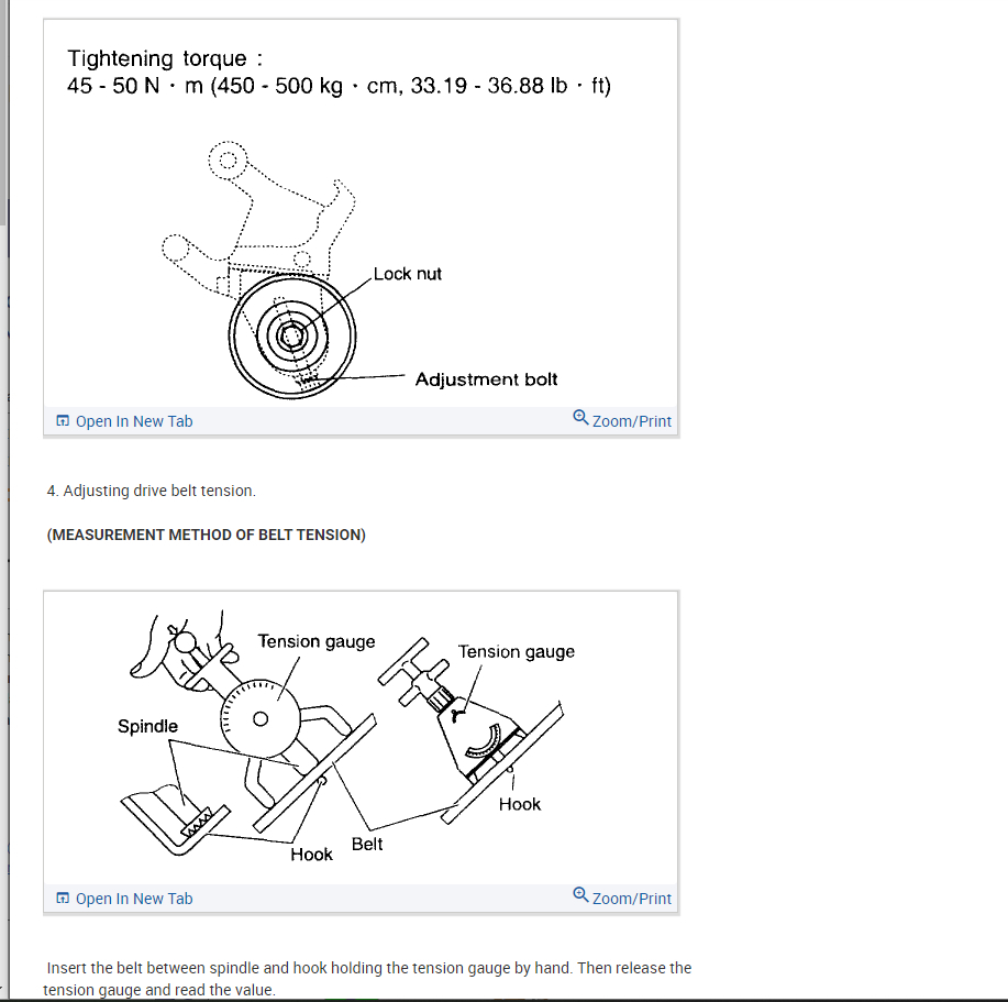

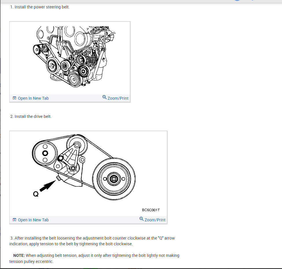

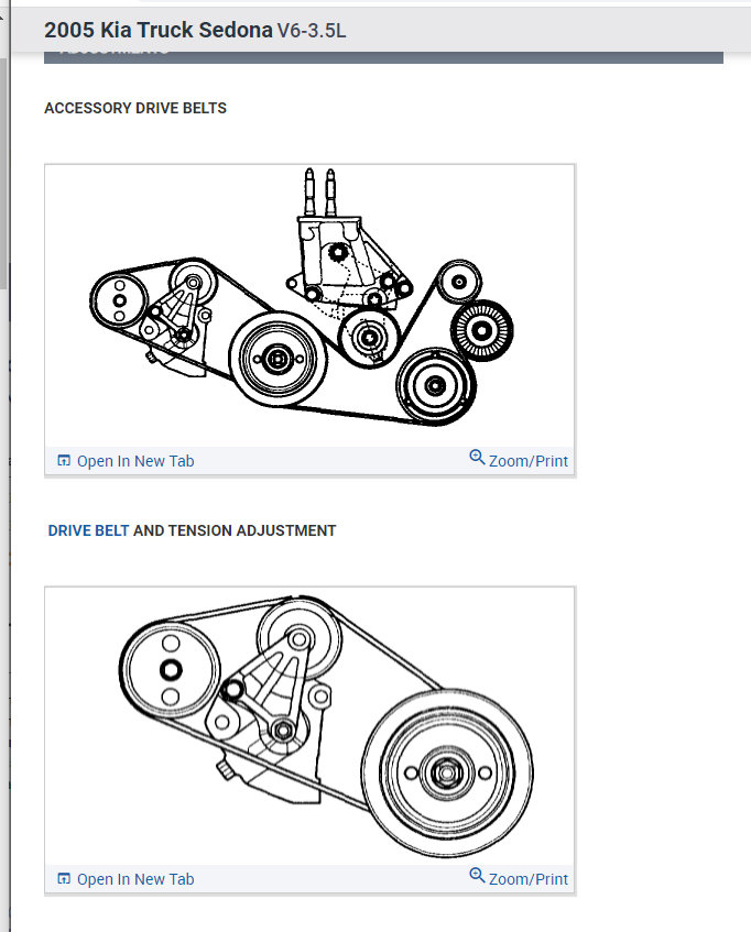

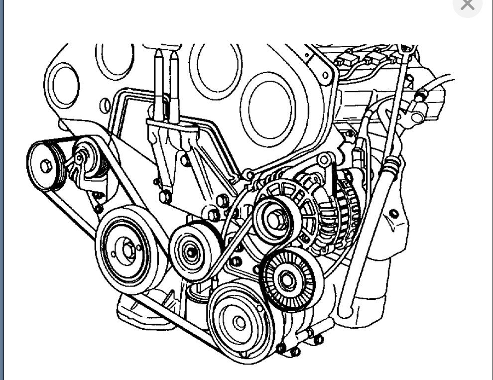

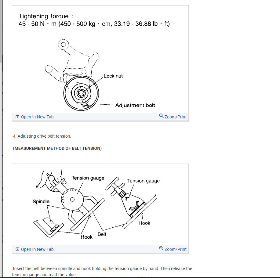

how so i release tension on the belt
Jan 14, 2009 at 4:53 PM
I am attaching the info below but here is a guide that will help with this:
https://www.2carpros.com/articles/serpentine-belt-tensioner-replacement
On this vehicle you have an adjustment bolt that you loosen and it will remove tension.
The diagrams below will show the location of this info.
Please let us know if you have other questions. Thanks
