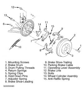

How do I remove the rear brake drum?

Hi there. With the wheel off you should see 2 philips headed screws, remove these, (you may need an impact driver) if the drum still does not come off, give it a sharp blow with a soft hammer, if it is still stuck there are 2 10mm threaded holes, fit 2 bolts and evenly do up this will with draw the drum.
