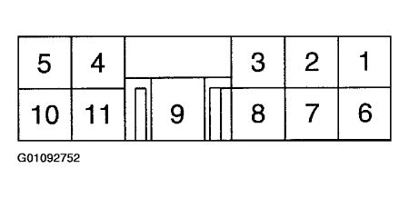

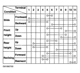

front passenger seat back and bottom will go foward but not back
Mar 1, 2009 at 6:38 AM
DAVE H
  • 13,383 POSTS
POWER SEAT MOTOR INSPECTION Disconnect the connectors for each motor. When the battery connected directly to the motor terminals, check if the motors run smoothly. Reverse the connections and check that the motor reversely turns. If there is an abnormality, replace the motors. POWER SEAT SWITCH INSPECTION Operate the power seat switch and check the continuity between terminals. If continuity is not as specified, replace the switch. Fig. 5: Identifying Power Seat Switch Connector Terminals
