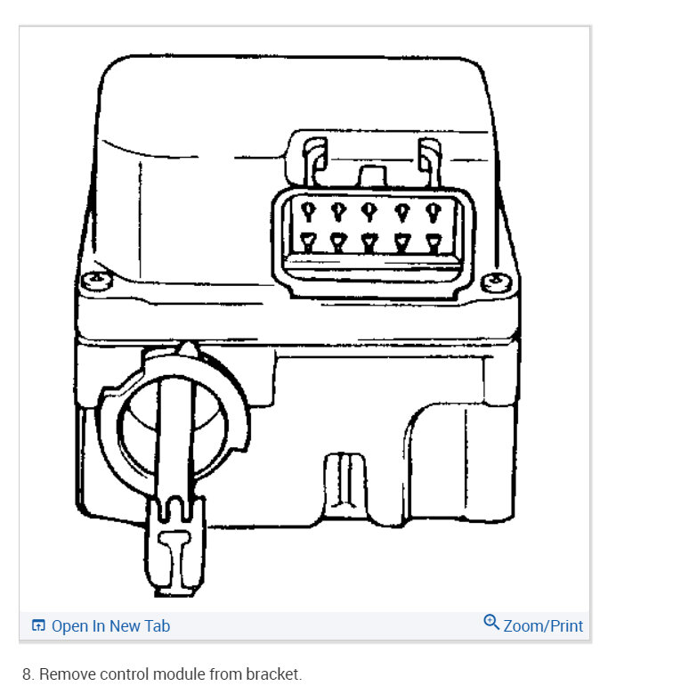

My cruise control is acting up. Sometimes it works fine, other times it will not set, resume, or anything. Sometimes it will turn off by itself for no apparent reason. Can anyone help?

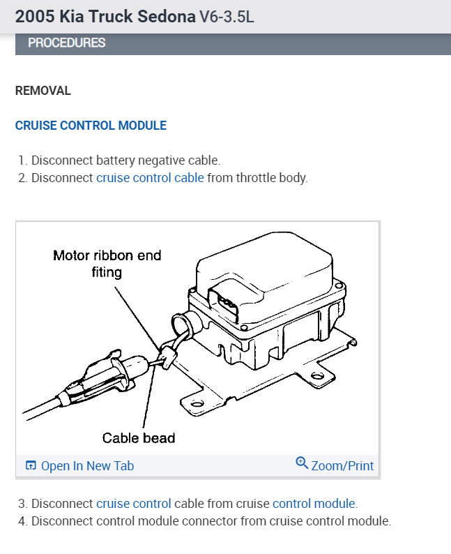

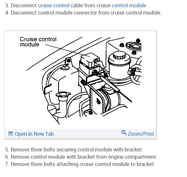

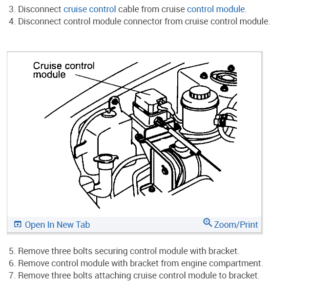

This happens when the cruise control module goes out and needs to be replaced, here is the instructions and location of the module in the images below. Check out the images (Below). Please let us know if you need anything else to get the problem fixed.
