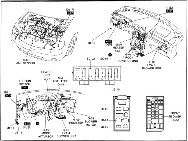

Where is the blower motor located?
2004 KIA SEDONA
ZIPPPPY
Air Conditioning problem 6 cyl Two Wheel Drive Automatic 42000 miles
I am pretty sure that the problem is the front blower motor. I have checked all the fuzes and the back blower works fine and is nice and cold. I know to check for 12 volts at the motor but I do not know where to find the motor.

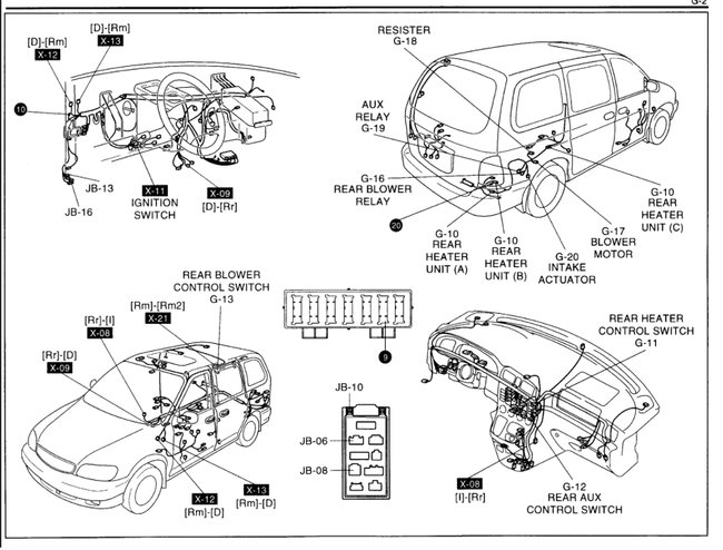

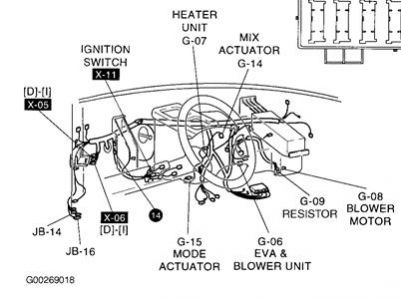

Hello, Here is a guide to help you see what you are in for when doing the job. https://www.2carpros.com/articles/blower-fan-motor-works-on-high-speed-only HEre are diagrams (BELOW) Blower Motor (Front)Behind right side of dash, on blower unit. See Fig. 26 .
https://images.2carpros.com/forum/automotive_pictures/266999_kia_31.jpg
Check out the diagrams (Below) Please let us know if you need anything else to get the problem fixed. Cheers
