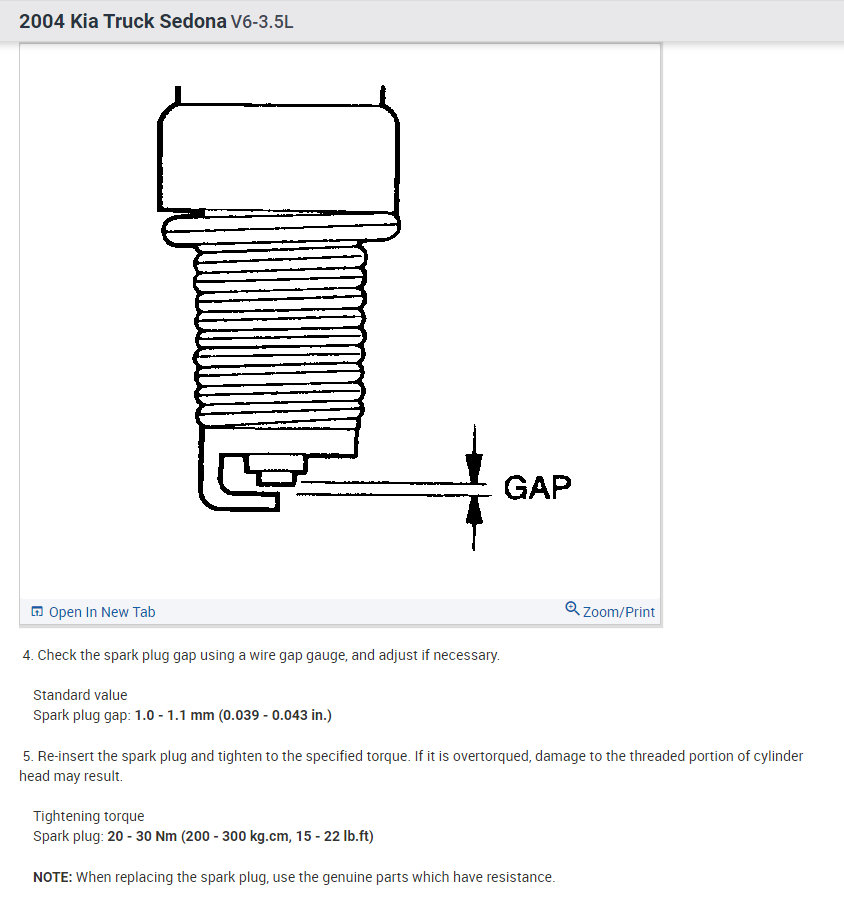

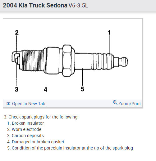

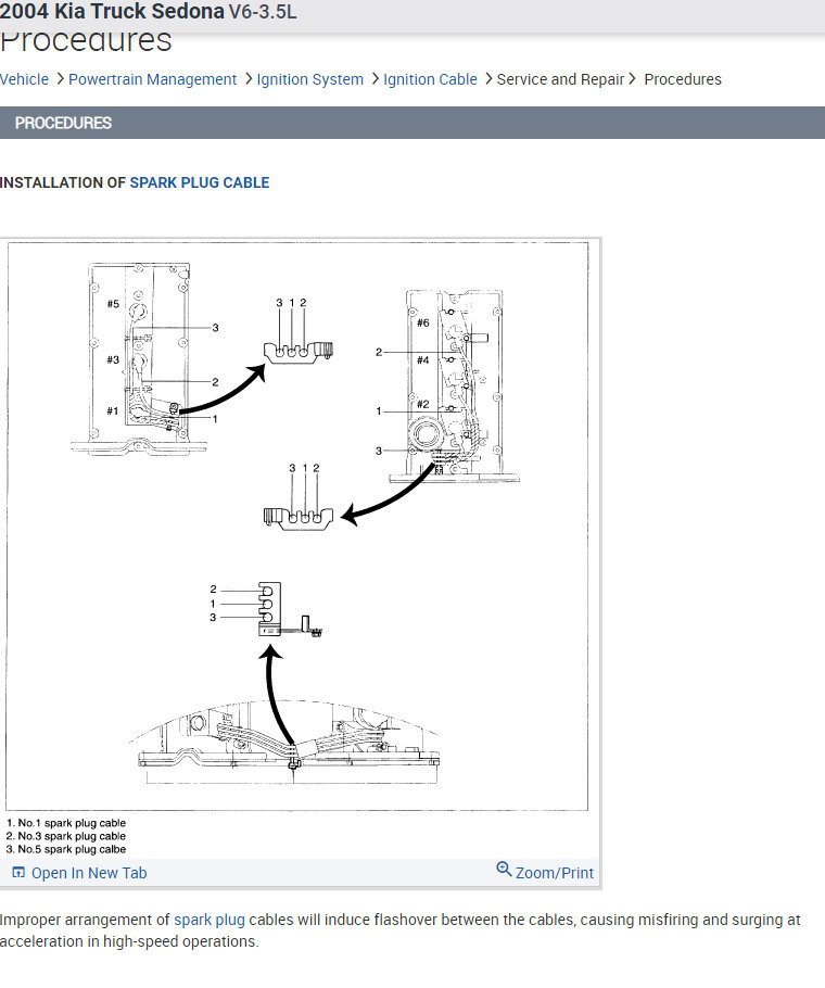

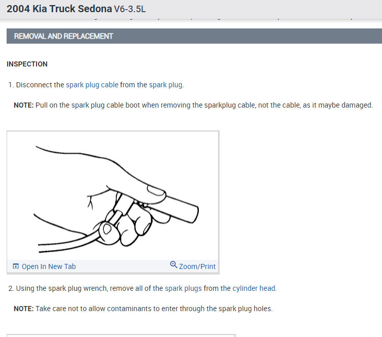

It sounds like the engine might be misfiring under load (acceleration).
When the ignition components like spark plugs, coils starts to fail they will misfire when you accelerate as there is more load on those components. Many times you will have good idle but will misfire as the vehicle starts to accelerate.
https://youtu.be/UKB-ytgbnzU
Check the spark plugs and make sure they are in good condition and the gap is correct.
Spark plug gap: 1.0 - 1.1 mm (0.039 - 0.043 in.)
https://www.2carpros.com/articles/how-to-change-spark-plugs
https://www.2carpros.com/articles/how-to-tune-up-a-car-engine
