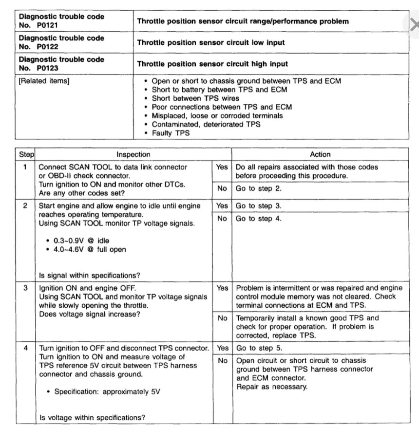

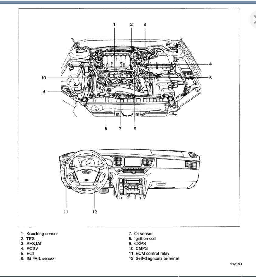

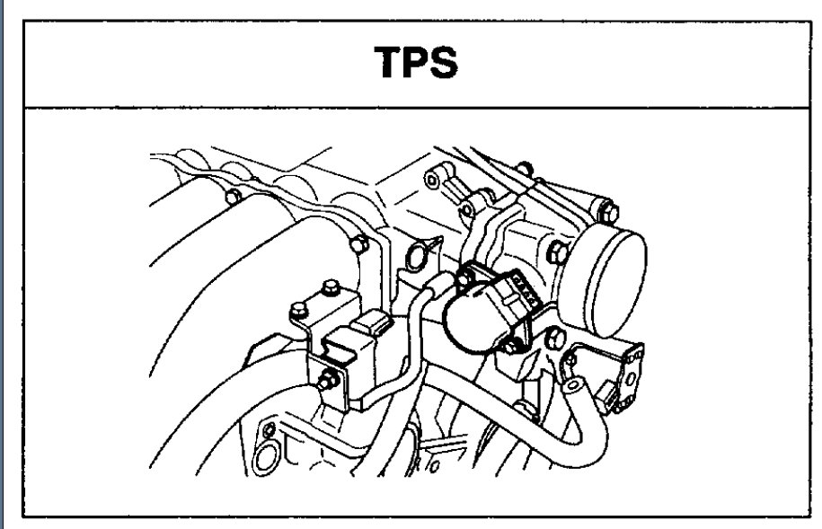

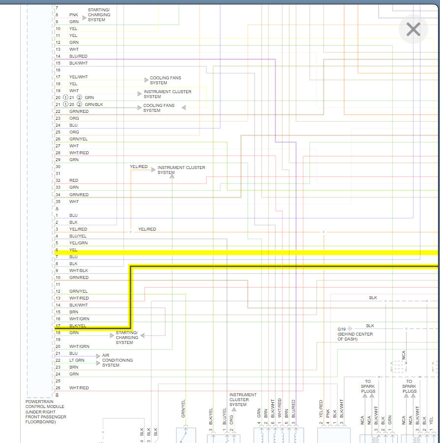

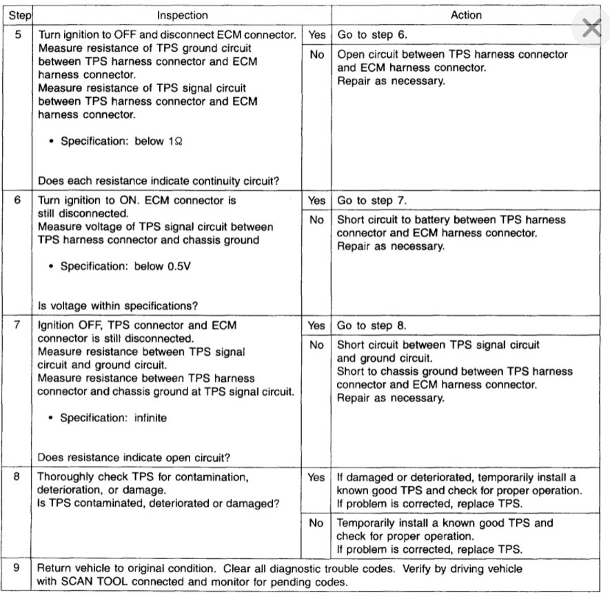

What is this code and how to do I test for it? Where is the TPS?
Feb 23, 2010 at 6:06 PM

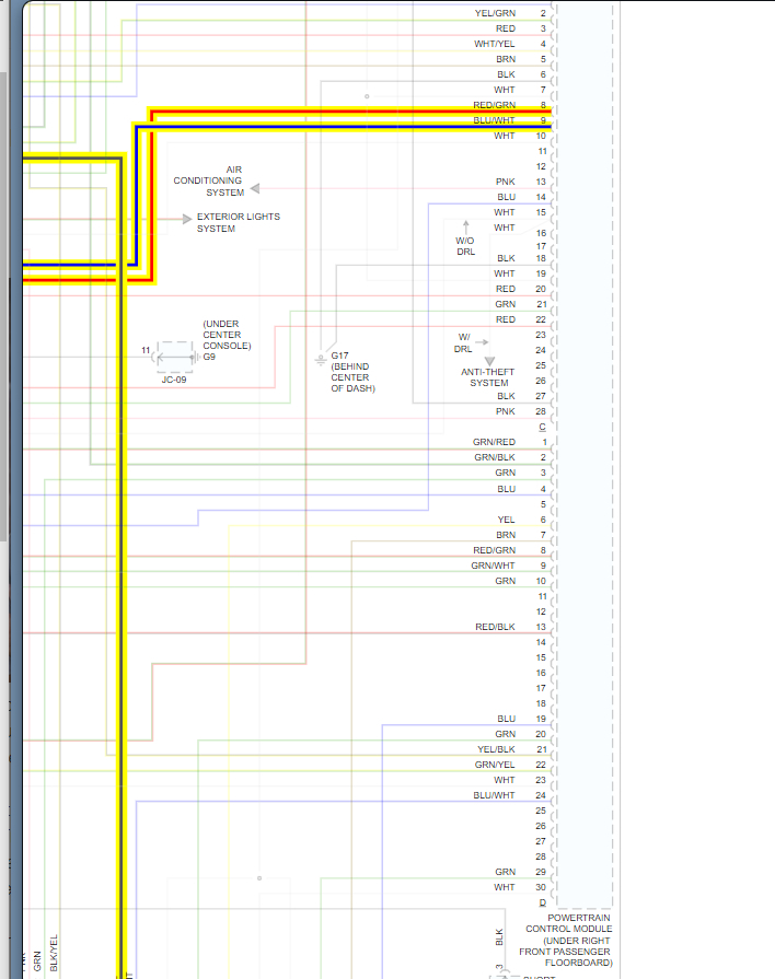

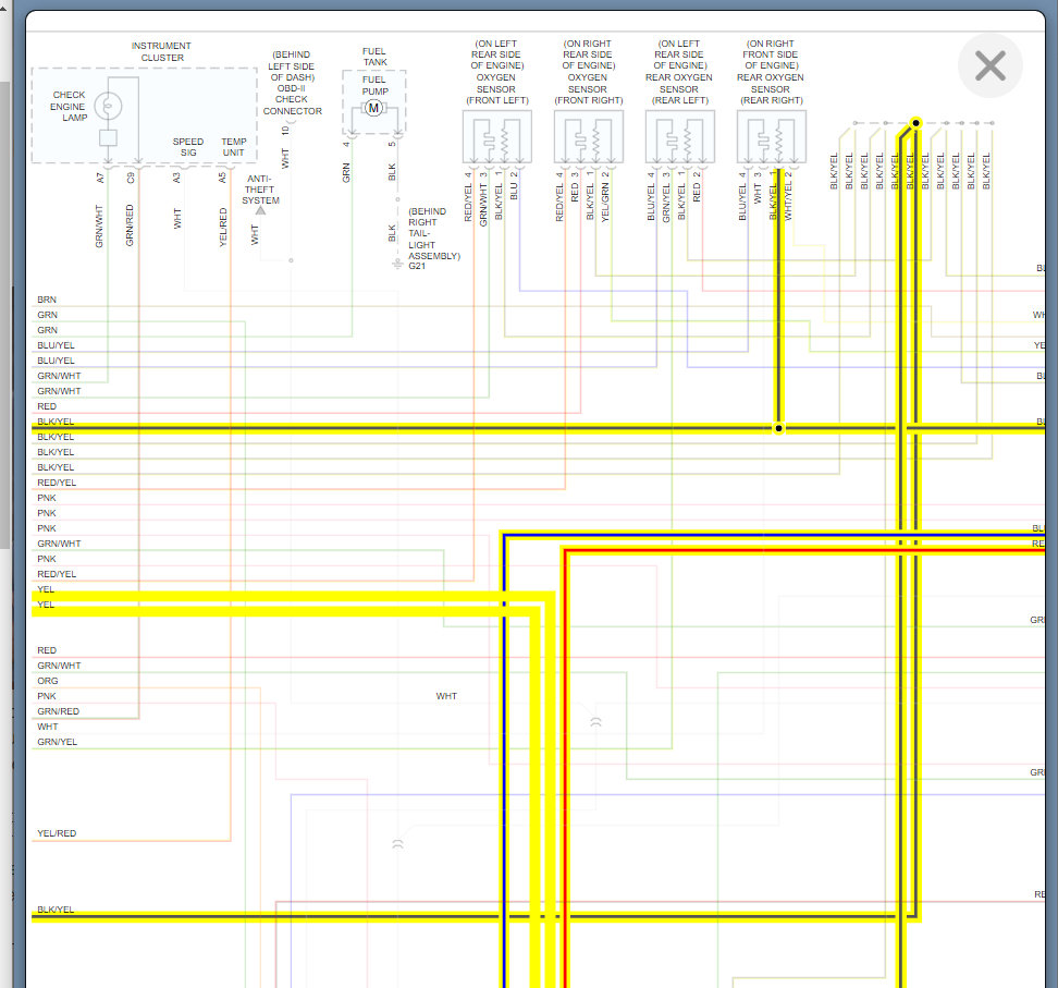

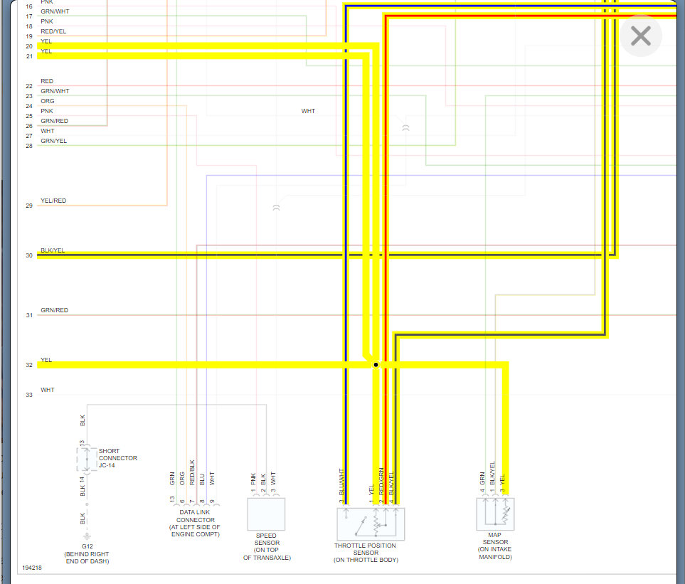

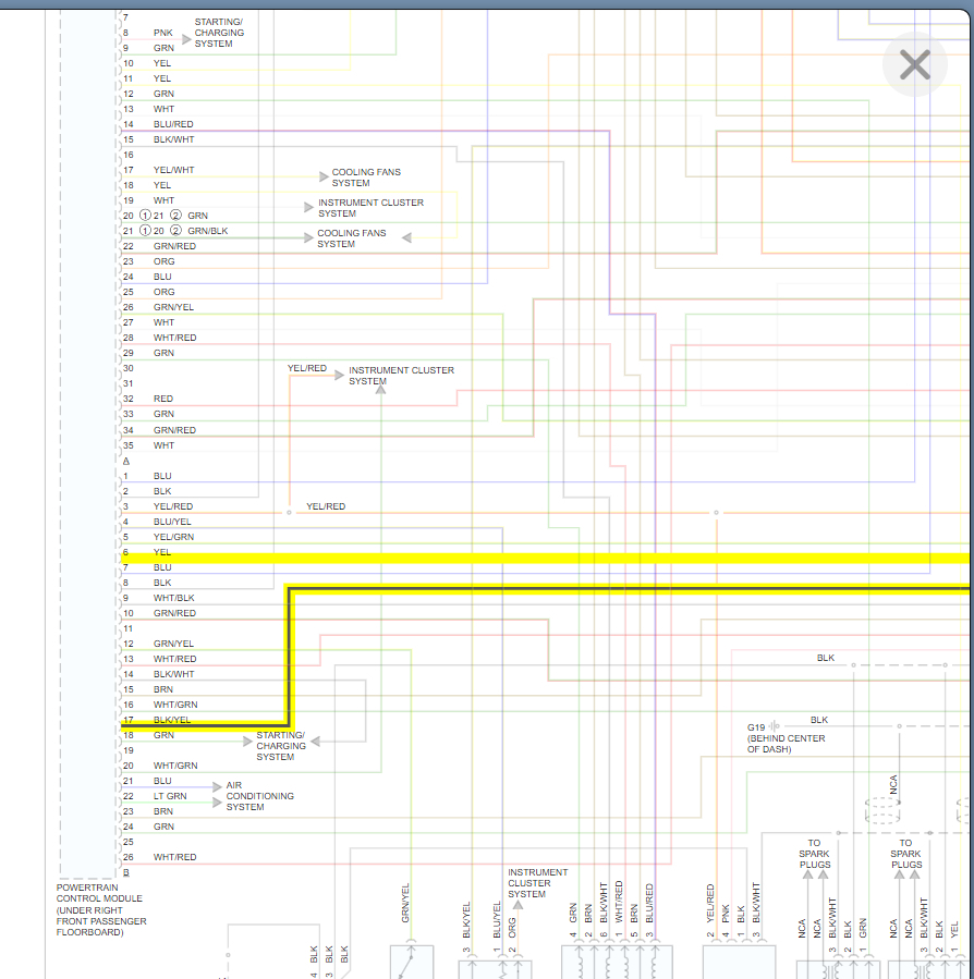

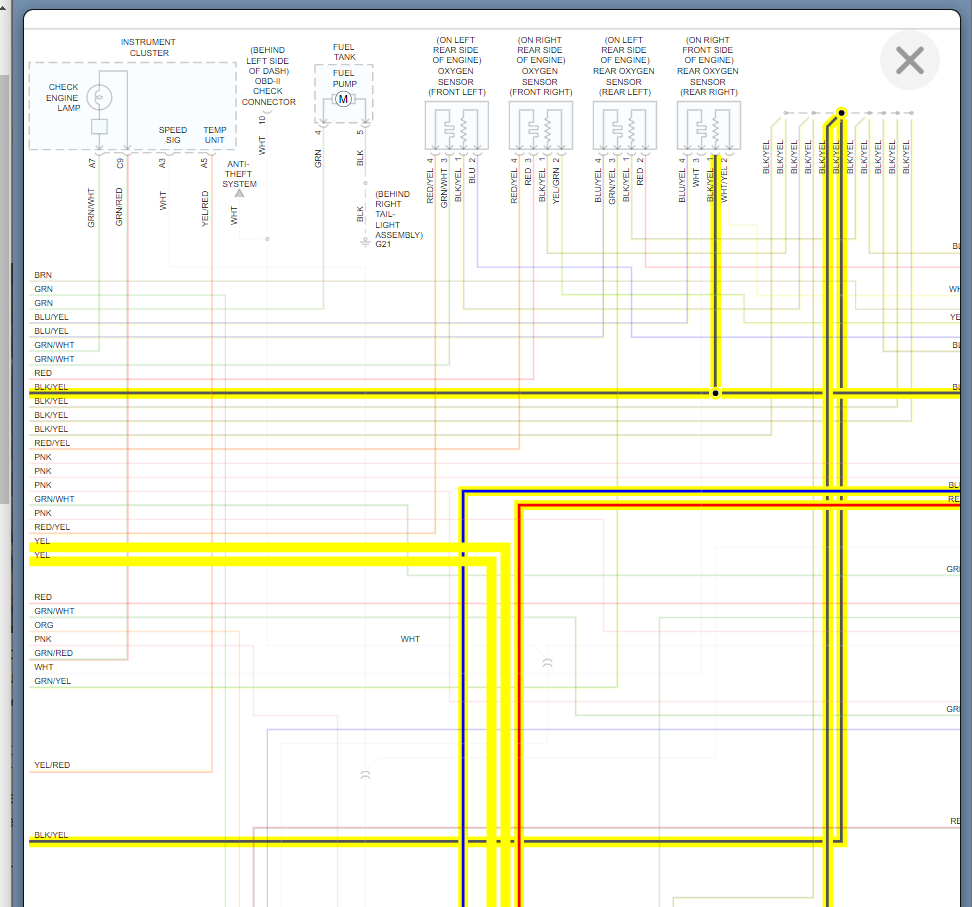

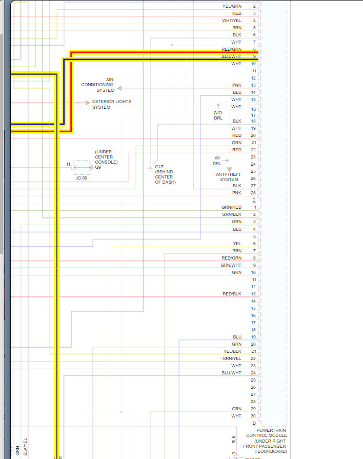

This code is for the throttle position sensor or circuit issue. I am attaching the info but here are a couple guides that will help with this type of testing.
Below you will find the info on this code, wiring diagram and location of the TPS which is on the throttle body sensor.
Please run through this info and we can go from there. Thanks
