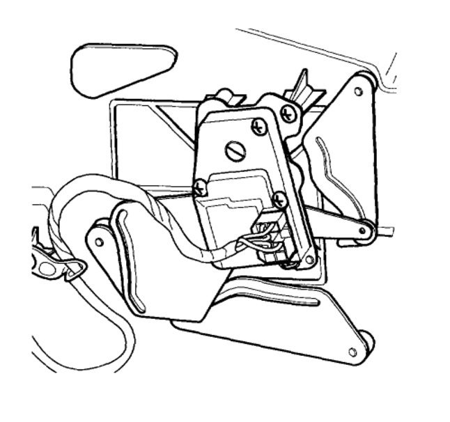

my 2002 kia sedona EX 3.5 L 6Cyl. the front heater is blowing cold air while the rear is blowin warm air, i was thinkin to replace the thermostat, and everything started happenin after my a/c stopped workin, do you think this is related?, what do you think it could be causing this? a honest answer is appreciated. God bless!

This is a blend door actuator problem which needs to be replaced, here is a guide that will help you and a diagram to show you which one to replace.
Please let us know what happens so it will help others
