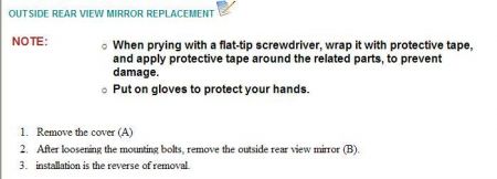

I purchased mirror and holder assembly from kia.How do I remove old holder assembly and replace it with the new part?thanks,phil

https://images.2carpros.com/forum/automotive_pictures/261618_Noname_1530.jpg
https://images.2carpros.com/forum/automotive_pictures/261618_Graphic_8.png
