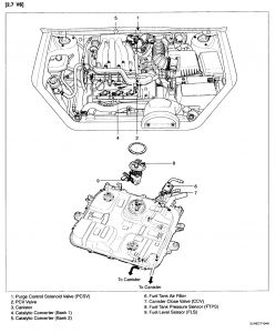

what does a pcsv valve looks like and where is it on the engine if possible a diagram thank
Sep 9, 2010 at 8:57 PM
  • 75,992 POSTS
Positive Crankcase Ventilation Valve Emissions Control System Components Location
https://images.2carpros.com/forum/automotive_pictures/12900_pcv1_4.jpg

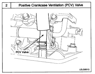

km07rondo_sm1_ec-007d
https://images.2carpros.com/forum/automotive_pictures/12900_pcv2_1.jpg
