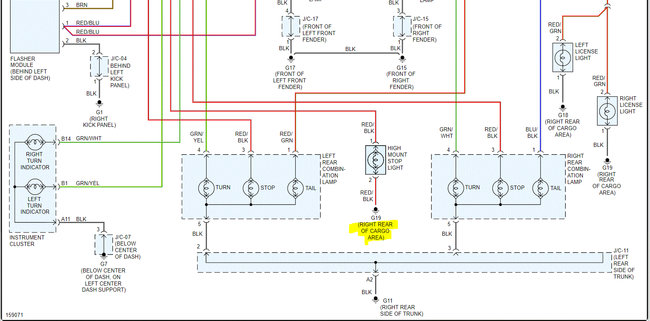

2003 Kia Rio Manual 38600 miles
My tail lights work fine but all three of my brake lights don't work. Sometimes I'll turn the car on and they'll work and then they'll stop and then out of nowhere (while still driving) they'll start working again. Sometimes they'll work for awhile until I hit a bump and they'll stop again. I tried looking under the dash to see if I could notice anything out of place or loose but I wasn't sure what I was looking for or at.

At the top of the brake pedal there is a switch that runs the light. Make sure the switch it tight and making contact with the pedal.

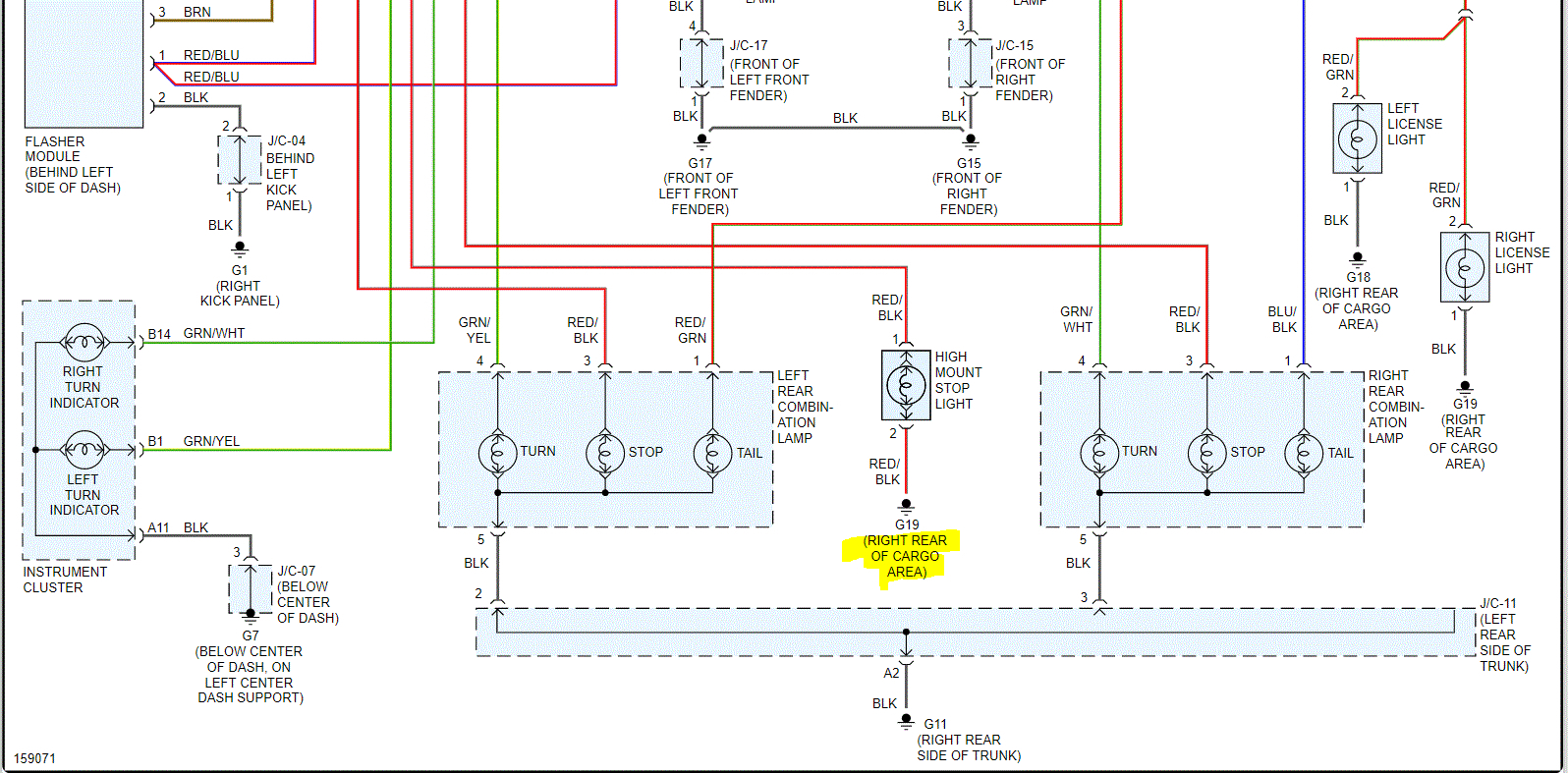

Found all brake bulbs were out. Thought it would be the brake switch. Also easier job to do. Replaced the switch. Bulbs still not lighting. Okay, opened the rear panels, etc. etc. replaced all bulbs. When done, I see that the lift-gate indicator light is lit up on the instrument panel. Now, the hatch is closed. Checked everything I touched three times. No changes. When driving and I apply the brake, dash light goes out. And when the third brake light bulb is out of the socket, then the dash light stays on even if you apply the brake. Maybe somebody knows how to remedy this.

It sounds like the ground is being taken away when the 3rd light is installed. What I need you to do is check the ground for the 3rd brake light. It is separate from the rear tail lamps.
If you look at the attached pic, I highlighted the ground I'm referring to. In the schematic, it identifies the location. Check this and let me know what you find.
Also, here is a link you may find helpful. It explains how to check the wiring under different conditions.
