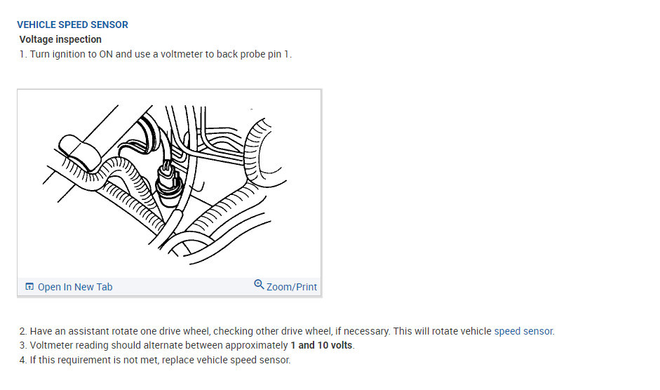

the speedometer is just stopped working I heard that it has a sensor but not sure where it is or how to test it.
Jan 25, 2009 at 8:44 AM

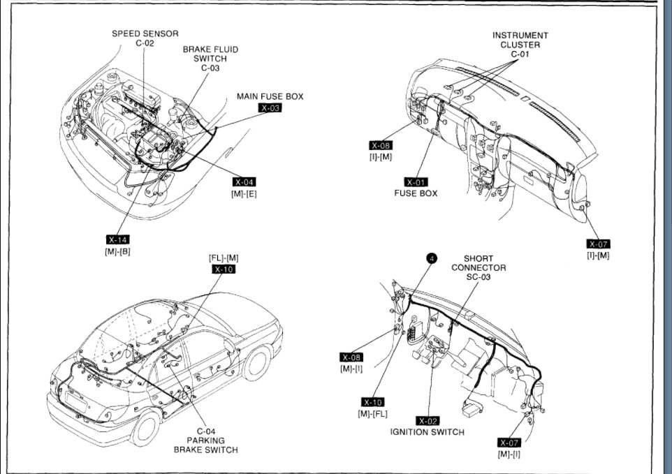

More than likely this is a vehicle speed sensor issue but we need to test this by checking the voltage it is producing.
Here is a guide that will help with this testing:
Please see the info below for the location and testing of the sensor. Let us know if you have other questions. Thanks
