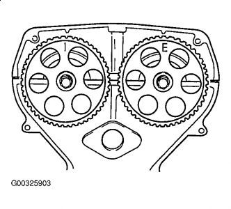

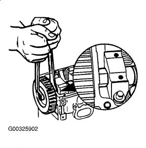

Dave hey and thanks for the information, it was very helpful on decissions for the future. Had the head redone, and all 16 valves were bent, but the rest of the head was fine. My question now are to make sure the shop that put this head back together has everything back the way it needs to be. For if it's not, I can line up the timing marks and the same thing can happen. I have attached picture for the questions I have for this model. Question: (on all pictures the left is the intake manifold side, and the right is the exhaust manifold side of the cyliner head). On picture 100_1380, shows the top side of the cylinder head. Should the longer cam go to the intake manifold side? On pictures 100_1377, 100_1378, 100_1379, How should the pulleys go back on both cams? The cam pins should be facing which mark on the pulleys, E or I? Dave Thank you and May God bless you and all who knows you bro, OHIO28 Hey Ohio The camshafts look good to me !! .. Install the camshaft pulley. Tightening torque: 55.0~77.4 lb-ft (74.5~104.9 N-m, 7.6~10.7 kg-m) Fig. 64: Installing The Camshaft Pulley Courtesy of KIA MOTORS AMERICA, INC.
https://images.2carpros.com/forum/automotive_pictures/266999_cam_10.jpg
Check that "I" mark on intake camshaft pulley is aligned with mark on seal plate and "E" mark on exhaust camshaft pulley is aligned with mark on seal plate. Fig. 65: Aligning Camshaft Timing Marks Courtesy of KIA MOTORS AMERICA, INC.

Let me know if you need any more information !!
