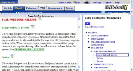

How do you replace a fuel pump in a 2003 Kia Rio?
Jun 23, 2008 at 8:33 AM
Experienced Mechanic
75,988 POSTS
See below-fuel pressure release
